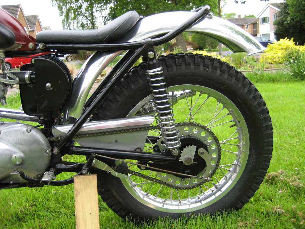

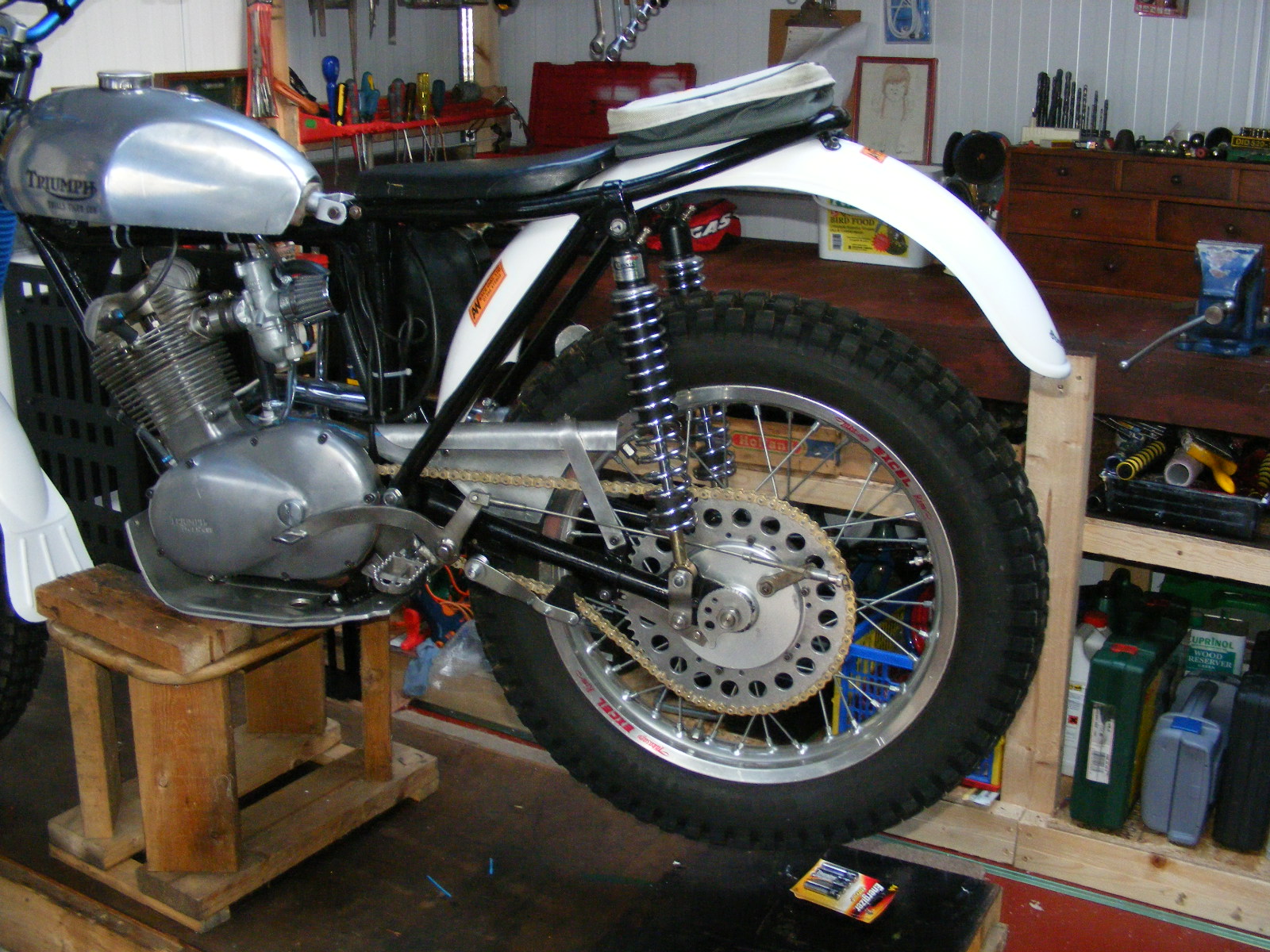

vinnied Posted February 12, 2009 Report Share Posted February 12, 2009 As John said TY 175 pic attached, if you need more pics let me no Vinnie Quote Link to comment Share on other sites More sharing options...
rogerroger Posted February 12, 2009 Report Share Posted February 12, 2009 Steve This is a miller swing-arm, so it came with a mounting lug. Tensioner is from Sammy Miller, but the spring location would need improving (bit crap as standard) Roger Quote Link to comment Share on other sites More sharing options...
