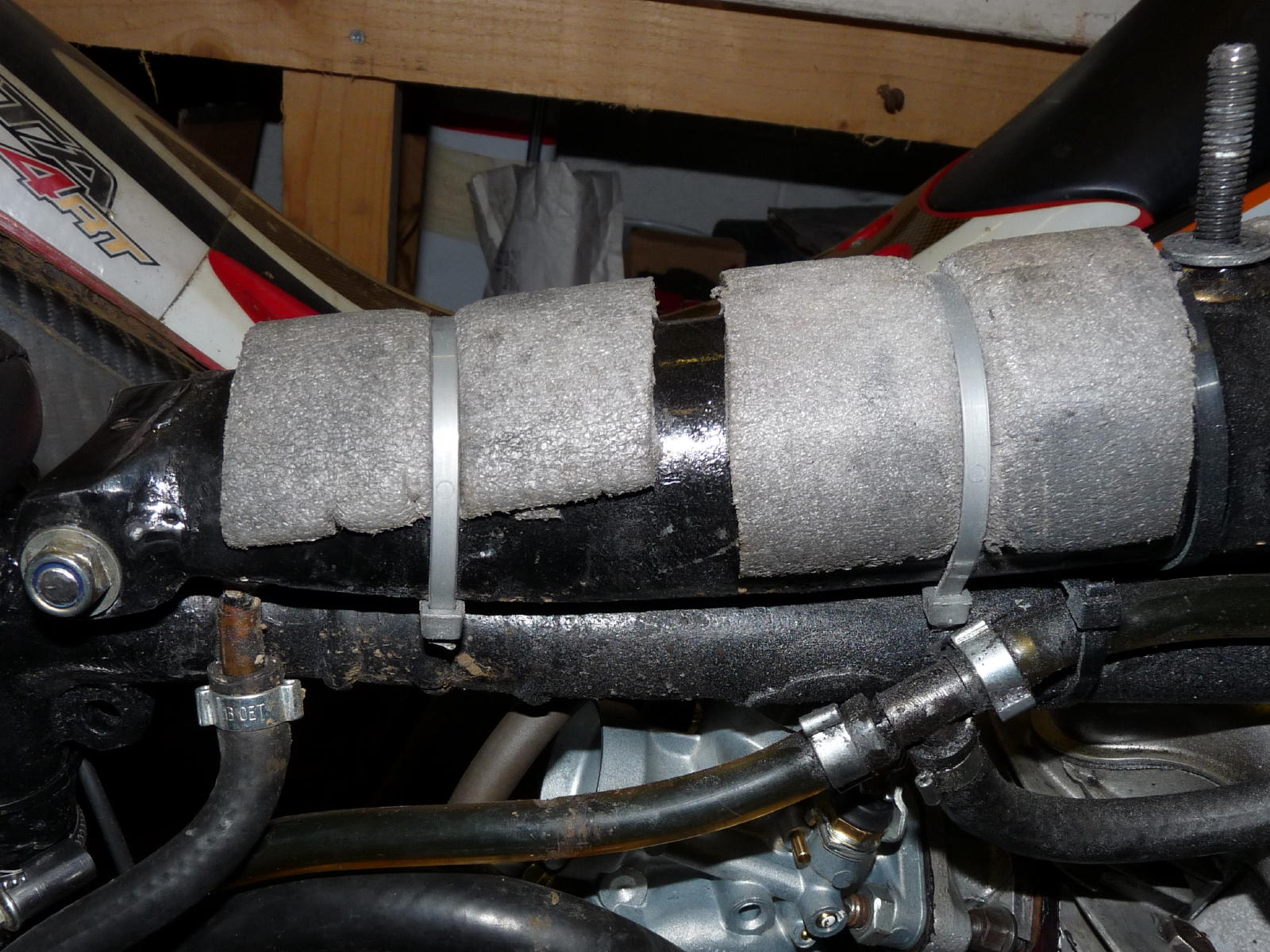

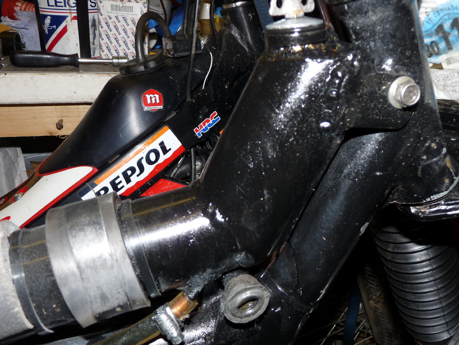

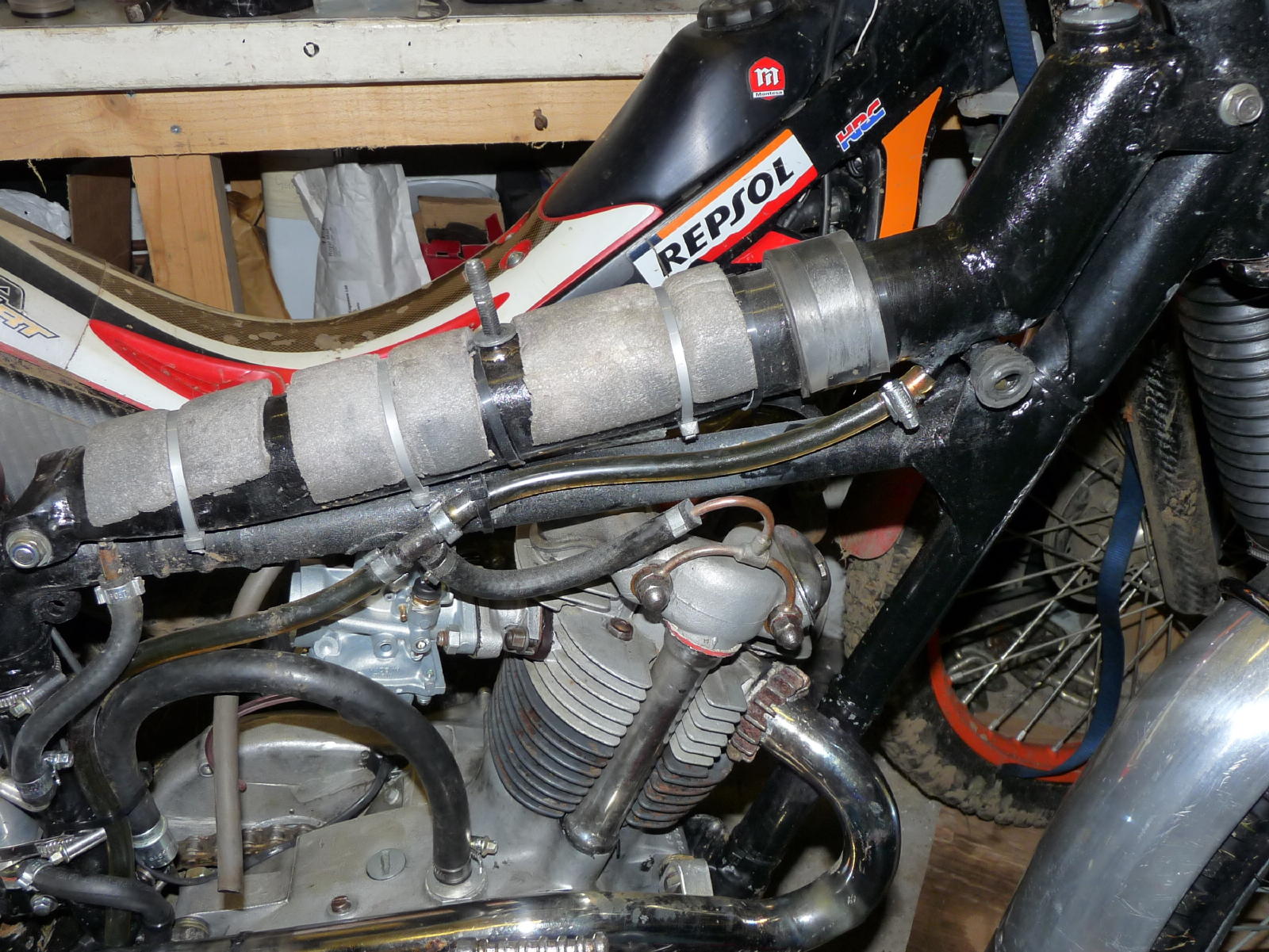

gii Posted November 8, 2009 Report Share Posted November 8, 2009 (edited) My Cub has an unusual top tank oil tube arrangement, made by the previous owner. PM me if you need more details Edited November 9, 2009 by GII Quote Link to comment Share on other sites More sharing options...

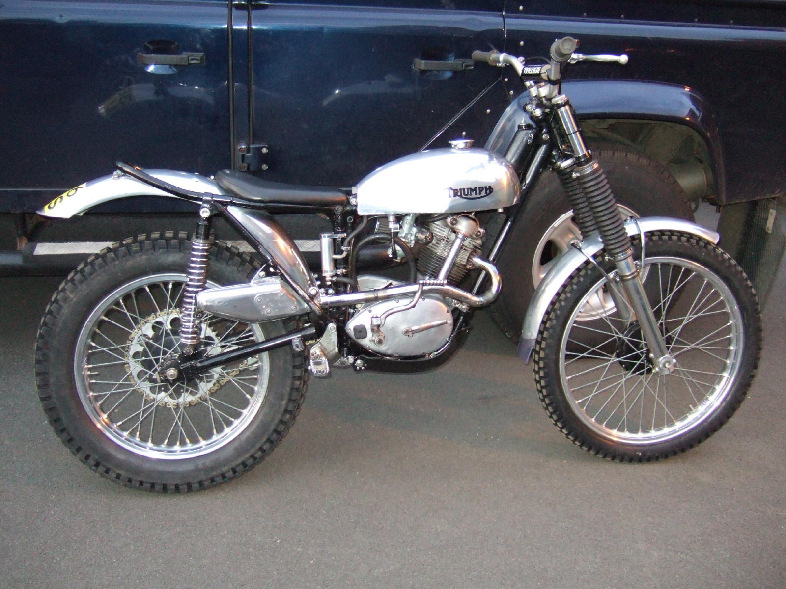

gii Posted November 8, 2009 Report Share Posted November 8, 2009 The finished article Quote Link to comment Share on other sites More sharing options...
mik60ish Posted November 9, 2009 Author Report Share Posted November 9, 2009 Thanks for the pics Gordon bike looks really good I was thinking of making one out of alloy to fit between the top and middle brace, as I have an alloy petrol tank which is fitted front and back not like yours with the bolt through it. I see you have an oil filter as well. And I need to move my foot pegs like yours. Did you get the geometry from your 4RT, as I was thinking of copying my GasGas TXT Pro set up! Quote Link to comment Share on other sites More sharing options...
gii Posted November 10, 2009 Report Share Posted November 10, 2009 The photos are of the bike the way it was when I bought it, and I've not substantially changed it since other than to lower the pegs about an inch. The forks are Cerianis and are a bit long, I guess they were off a scrambler, I'm investigating a pair of parallel yokes instead of standard Cub ones to try and steepen them up a little Quote Link to comment Share on other sites More sharing options...
