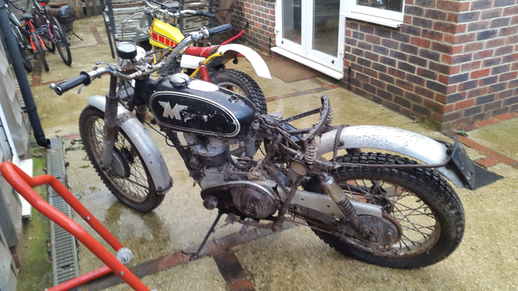

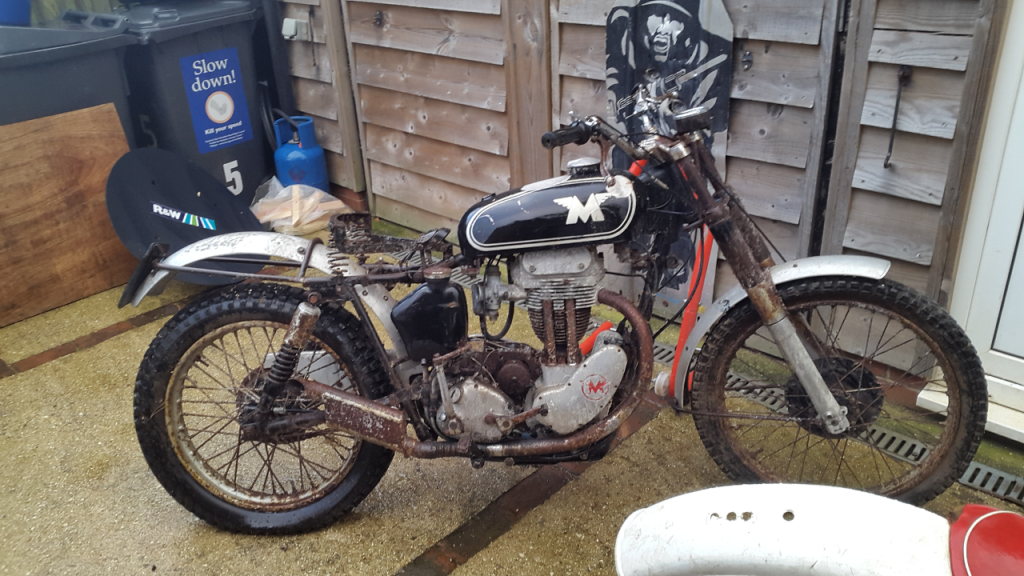

mjc477 Posted October 17, 2016 Report Share Posted October 17, 2016 Picked this up with the little yamaha just now Believe it's a g3... Not sure if it is a trials model but it is in trials trim The rain makes it look better than it is Any ideas on correct id Quote Link to comment Share on other sites More sharing options...
laird387 Posted October 17, 2016 Report Share Posted October 17, 2016 (edited) Sorry, It isn't a trials model, Eng number would include G3C, and they had areadsy gone to alloy motors before they went to a spring frame, not a trials frame either - but having said that could still be a load of fun in the right trials - as long as you just want to be joining in - not winning trophies. Full development history - model by model, year by year is in our digital magazine. To whet your appetite here is an AMC sales poster picture of the 347cc trials model introduced in September 1958 as the 1959 model, seen here in Matchless colours. The noticeable point of this model, immediately dubbed the ‘Jackson Replica’ but never sold as such by the factory, was the flattened tube ends of the swinging arm around the wheel spindle. All its predecessors were longer and heavily lugged at this point. Note that the rear suspension units were the same length, 15.5”, as those fitted to the lightweight 250s, except the spring rates were different and the trials models had the adjustable spring preload. Edited October 17, 2016 by laird387 Quote Link to comment Share on other sites More sharing options...
mjc477 Posted October 17, 2016 Author Report Share Posted October 17, 2016 Thanks for that..as I thought not a trials... Has a nice look to it though.. Probably leave as is and let someone else have the fun of sorting it Thanks again Quote Link to comment Share on other sites More sharing options...

mjc477 Posted October 31, 2016 Author Report Share Posted October 31, 2016 Well ...compression was good so I thought what have I to loose.. Freed everything off ...carb is spotless...flushed engine ...Everything doing what it should...snapped plug of flush????bugger... Head off got that sorted ....magneto just sent off tonight for rebuild as it was dead as a dodo ...so hopefully good to go when it comes back... Does anyone have a tatty seat they don't want...probably a single sprung job would do ..nothing to clean! Quote Link to comment Share on other sites More sharing options...
