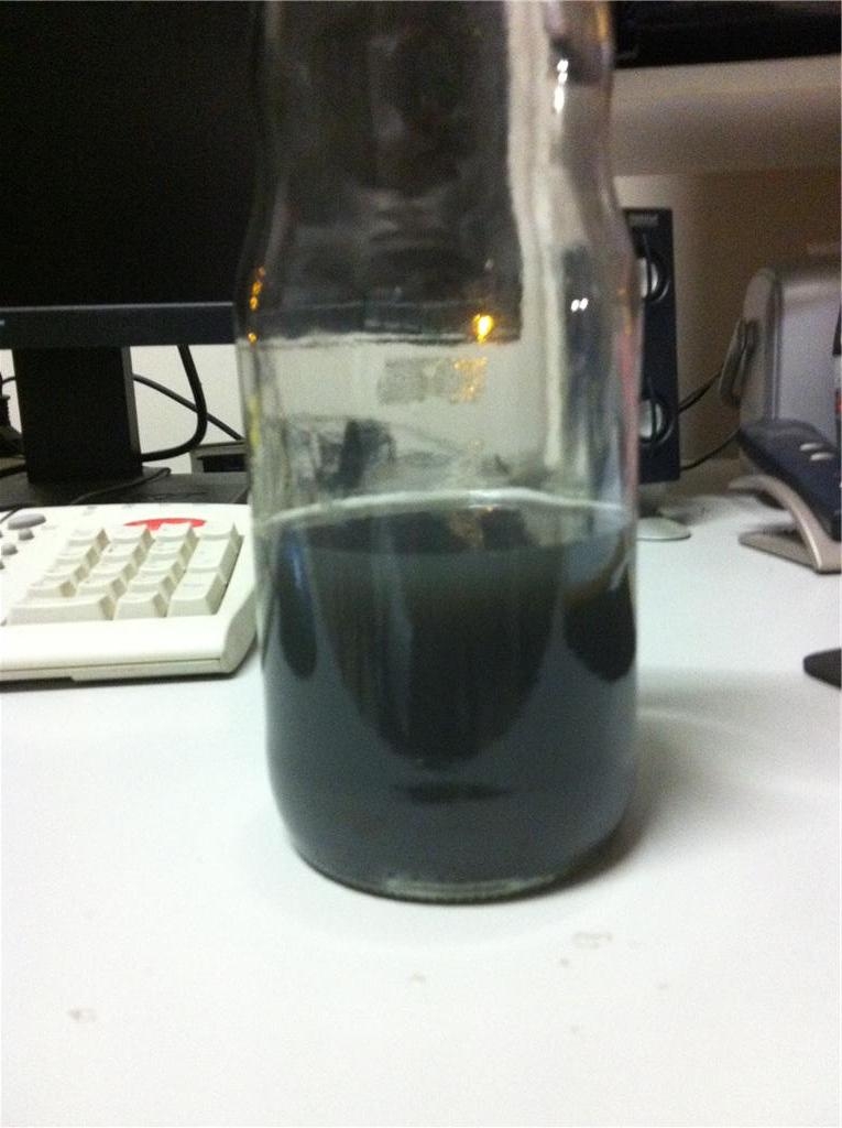

This is the supplied coolant from my 2012 Ossa TR280i which is approximately 5 months old. The gearbox oil doesn't have any water in it.
The coolant appears to have either broken down or its contaminated with alloy or a combination of both? Would appreciate input from anyone who's seen something similar?

To be honest its more likely to be alluminium corrosion. Get hold of a Ph testing kit and check the Ph of the coolant as it might be slightly acidic. Ph should be around 7 to be neutral. If acidic you will need to find a better coolant to suit the bike. Once done if proven to be acidic i would contact Ossa and give them an a*** kicking unless you have deviated from the recommended coolant and if so flush the system and replace with the recommeded coolant only.
