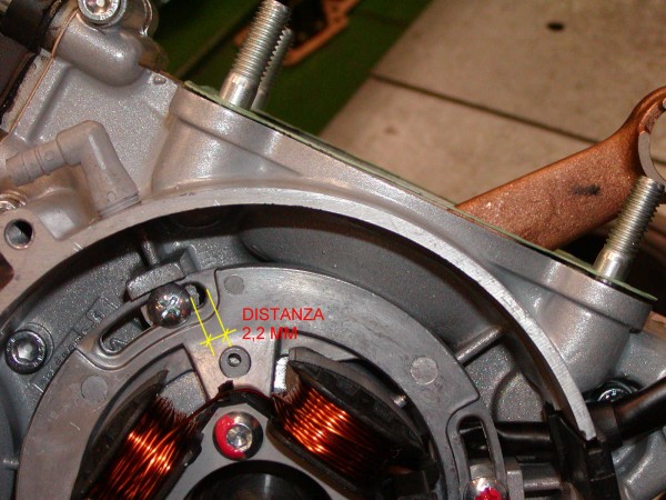

paul w Posted November 12, 2005 Author Report Share Posted November 12, 2005 how is the ignition timing set? is it done via a stobe whilst running? or is it static set using a dial gauge? anyone know what the correct values are? Quote Link to comment Share on other sites More sharing options...
bob Posted November 12, 2005 Report Share Posted November 12, 2005 there are ignition timing diagrams on JLI's website. www.thetrialcompany.com If you have a bike which is <03 model or which is a 200 then it will have a different stator so don't set your ignition timing up like this! Bob Quote Link to comment Share on other sites More sharing options...
