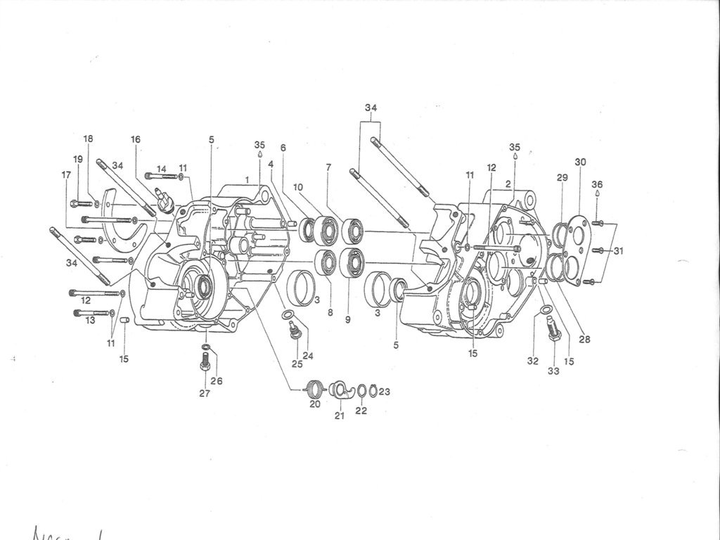

  5. Hi Patrik, I bought an Aprilia air cooled 280 in a box. Had some bits done and started to put it back together. In the box with the Gearbox bits, ther is a tensioner of some sort which I can't place. Nothing the like on the SWM 125 and 280's I've rebuilt so far. any ideas ? I can send a pic but I wanted a first thought. Wierd, I usually fathom things out but this has got me boggeled.
    Thanks,
    Phil
    1. pschrauber
      pschrauber
      Hello Phil,
      that is no. 239 755 the index spring and no. 248 977 the index lever assembly for the TXR 312 engine (definetly
      and may be the MKII of the late TX311) so you are swapping / mounting a very late aircooled mono engine to which bike?
      The trust washer is no. 227 800 16,2/21/0,4 I can't see, is missing!, the other item above must be no. 945 840 the locking ring DIN 471 15x1mm.
      The assembly should sit down right, the roller facing upward towards the engine casing.
      Greetings
      Patrik
