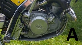

To Gas Gas Experts out there.
I think it is a 200 made in May 2002 number 201 16 02 05 02 0201 16 = 200 (175cc) 02 = Model year 05 = Month manufactured 02 = Year of manufacture 0201 = sequential production number
