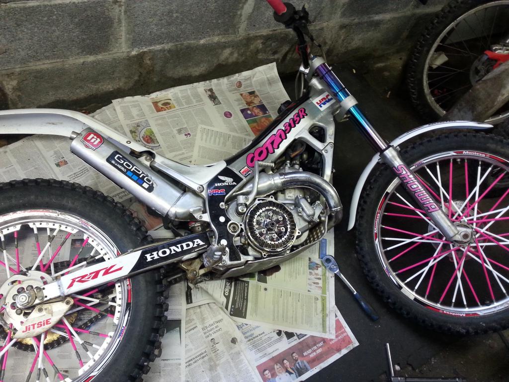

Ok update! clutch was slipping and slipping badly, thats why there was alot of clutch drag, this montesa 315r was hard to tell or spot the clutch slipping (not like gas gas while trucking along you can hear and feel it slipping) the monty just reved up a bit but it took someone watching the back wheel to see if it spun out but it didnt,
so went online and bought a clutch kit with the steel dimpled plates as well, and fited it in no time, put some dex III in and its working awsome! apart from a small friction noise when you first pull in the clutch (hopfully because its new!) and hoping that might go away after a bit of use!
found out that is the 87-89 CR250/500 clutch that fits
Hopefully not slipping. I've two clutches damage by using the wrong oil and had to replace the frictions.
I have a CR250R clutch pack in my 315R with dimpled steels and it is IMO a fantastic clutch, I've used the ELF HTX740 oil but switched to Valvoline Dextron VI ATF (synthetic) because the Elf is difficult to find and expensive in my area.
I have a 2001 montesa 315r! so what year of cr250r clutch kit will fit it?

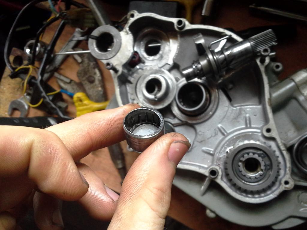

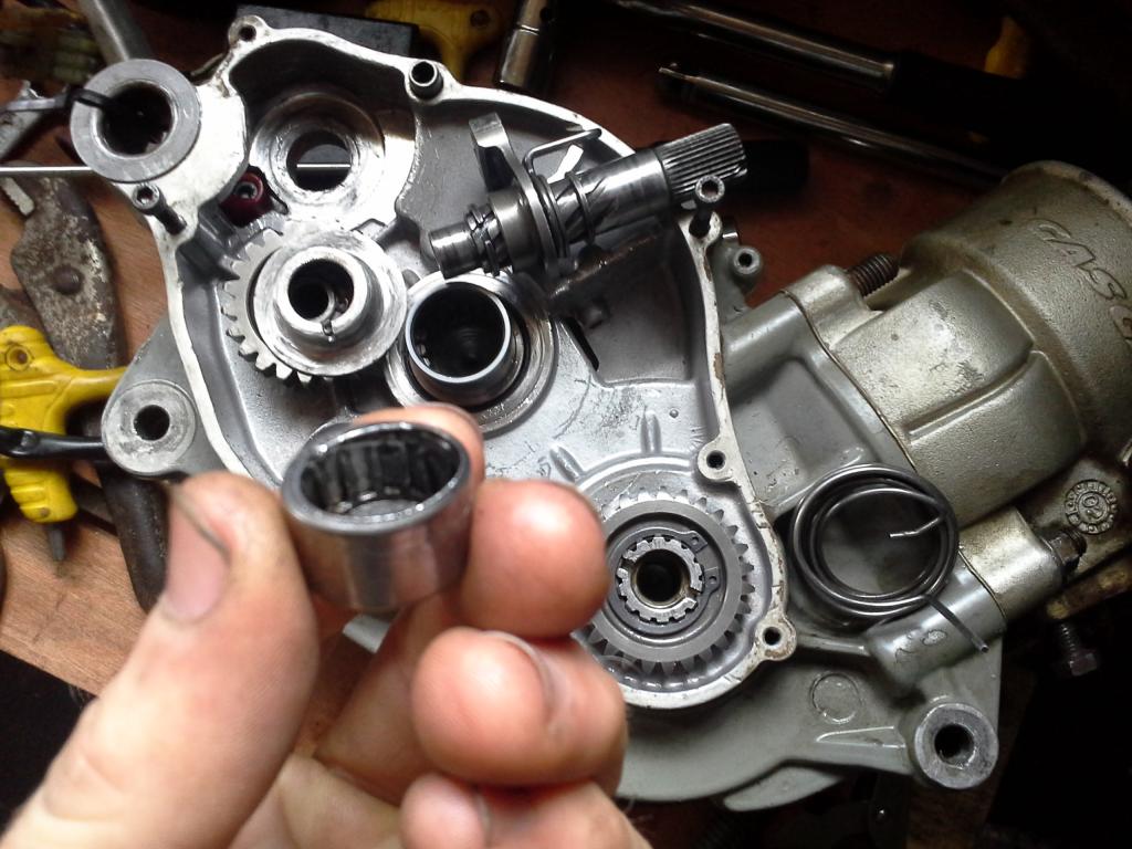

also does anybody know anything about the kick start baring.... see my pics below........ I tryed to remove it this morning but the whole carrier for it poped out! wonder is this a single unit?
Hi Guys, has anyone any experience in the txt gas gas kick start spring? I am in the process of putting my engine back togeather and now I can't get the kick start lever to return back in to the storage place, the spring has got loose now and its like mission impossible to try to wind up the spring and then put the kick start shaft in to it.... so I am thinking my next move is to buy a new one, wonder does it come tensioned?.... oh and does anybody know what the part code for the needle bearing that the kick start shaft sits into?
