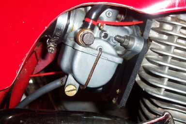

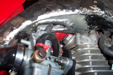

griffiths of wales Posted August 24, 2006 Report Share Posted August 24, 2006 Fellow Seeley owners....Just completed my 1st trial since fitting a bigger carb to my bike...huge improvement in performance. The bike now revs out much better, pulls away from low revs much smoother and idles at a steady rate. Fitted a larger carb (from a CB250 twin I believe..pics to follow may confirm), had to drill a hole through the tank and weld in a tube to route the throttle cable through (pic to follow). The new carb is about 15mm taller than my original hence the mods. I also had to slim down the connection block to about 8mm so that I could use the original rubber connector to the airbox. This really has improved the bike no end (I'll hurry up and get the pics posted) Cheers all, Mark. Quote Link to comment Share on other sites More sharing options...
griffiths of wales Posted August 25, 2006 Author Report Share Posted August 25, 2006 As promised........regards, Mark. Quote Link to comment Share on other sites More sharing options...

griffiths of wales Posted September 3, 2006 Author Report Share Posted September 3, 2006 The motor capacity is as original (198 cc)..the carb I fitted is a Kehin PW22. Best of luck with yours. Quote Link to comment Share on other sites More sharing options...
