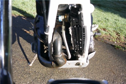

the artist formerly known as ish Posted March 1, 2004 Report Share Posted March 1, 2004 Oil cooler. yes it does help, also gives the bikes a little more oil capacity as they don't hold much standard. It was an option the oil cooler set part number 06150-NN0-700 My bike does have one on so I will go and take a picture and post it under this topic Quote Link to comment Share on other sites More sharing options...
the artist formerly known as ish Posted March 1, 2004 Report Share Posted March 1, 2004 Keep in mind the downpipe is different with the oilcooler for clearance Quote Link to comment Share on other sites More sharing options...
the artist formerly known as ish Posted March 1, 2004 Report Share Posted March 1, 2004 Model shown came from the factory like this Quote Link to comment Share on other sites More sharing options...
gaff Posted March 5, 2004 Author Report Share Posted March 5, 2004 Cheers guys, especially Ishy, the 85/86 i have seen has the oil-cooler rather crudely bolted to the out-side of the left down-tube, and not inside out of the way like yours. Is yours an 88 ? I was thinking about putting one on my 87, if i can get hold of one ! Gaff. Quote Link to comment Share on other sites More sharing options...
