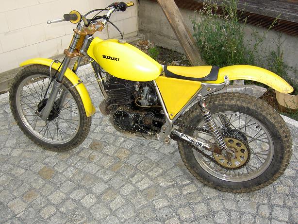

Whilst at the 2-day Dartmoor Trial this weekend (great trial, thanks to Bill Hartnell and his helpers!) I swapped one of my Fantic 200s for clean looking 325 Beamish. Maybe a bad move from a competitivness (?) standpoint but nostagia said I needed a Beamish as I trashed the rearframe loop of my mates 250 back in 1979 using a hard place and 3rd gear!
This one has no rear loop to trash! It has the black engine and I think ist an 81 model. Although it looks clean it would not pull the skin from a rice pudding. The owner said it woz once owned by Nigel Birkett (are you reading this?) and had been converted to 370 using an AJS piston?? I think a ty 80 has more power! It will just about lift the front wheel in first, where is the 24 bhp? It looks std apart from a WES silencer. It rattles alot and the owner said it was the fins with no rubber spacers! He had supposedly fitted a new ring.
I have an original barrrel,anyone know the max OD before a rebore is necessary? Where can I get a piston , std or oversize? Are conrod kits available also? I have used 0,25mm oversize piston also which doesnt look too bad although if I am gonna pay for a new engine, I would really like a NEW one! Anyone know wot alternative parts can be used?
If I have a barrel for a fantic rechromed, I know the clearances needed (0,03mm) and the plating is done to fit the piston. If I rebore the std barrel, what clearance do I need to let it run ok without too much rattlin? (0,04mm?)
I am not expecting this lump to perform like one of my 240 or 300 fantics, but I feel cheated!!!!My TY 250 from 76 ist bags more powerful.
Would a 250 flywheel wizz things up abit?
Comments and help desperately needed....Also your feedback or comparison of the 325 would be great. Cos if this is as good as it gets, I

This model of Suzuki could be a 250 or 325, the only difference between the two is the piston and obviously the barrel. The 250 uses a 325 barrel with a sleve fitted and a modified cylinder head. The pistons for the 250 should be fairly easy to get but the 325 one is a special part which could be difficult.
Colin Appleyard motorcycles used to distribute parts for the Beamish years ago and might still have some information. Try them on 01535 606321.

Hi Lee, Yes you'll ride it in anger, every time you get on it, you'll think 'what have I done, am I a dumkorf'. Have you noticed, it don't start in gear, the earlier silver ones did. Make sure piston dimensions are the same, not just the bore. Whoever bores it should know what clearance for a liner engine, it's alot bigger than the Fantic with chrome bore. If the Hilary that posted is the northsea diver with no front teeth, then his original 325 was far from standard, it had lots of special parts including barrel and boysen reeds. Your bike probably just needs a good work over, nothing a grand won't put right. Check to make sure , it aint had a chair fitted, as this kills them prematurley. My other speciality are Austin A35's and Morris Marina's, as your an ex rally driver who used the BMC marque, you've now joined another elite group of 1950's design revamped to compete in the 70's and 80's. Yes you probably will be allowed to use it in pre 65, just paint the frame black and the tank green and call it a Lee Francis, or Francis Barnet, but what chance have you got against a BSA Bantam !

I had a 250 Beamish from new and it was a disappointment. It had too much flywheel, and if i remember correctly couldn't be started in gear wheras the earlier silver engined ones could.
The first of the Whitlock framed (red/black tank) ones were really interesting- they had a faulty gear selector drum, and the gear sequence went 1 2 3 5 4 !
As Robin said, the 250 was a sleeved down 325 (done in the uk) Easiest way to tell is if the '325' cast in at the barrel base has been ground off, if so its likely a 250.

I had a 325 beamish, but the earlier model that you had with the full rear frame loop. A friend once had a later model 250 without the frame loop just as yours has.
Mine was originally a solo but did have a sidecar, i think its unlikely yrs had a sidecar as the swinging arm was about 40mm longer, the headstock had a large boss / reinforcement to attach the chair just infront of the tank and the left hand footrest mount was reinforced. The sidecars also had different fork yokes.
Mine ran for years with little maintenance and invariably started first kick whatever the weather. Brings back fond memories, wish I had it now..... Could never get fork seals to last long tho for some reason.
Link to comment
I used to have a later 325 Beamish too and I liked it. The motor would pull out tree stumps, really strong and it gripped well. Steered a bit slow but that was the only negative, but so do mid to late 70s Bults. If yours is gutless it has something wrong with it or it is a 250. Should be no lack of power believe me.
As someone has already mentioned, the last of the Suzuki motors were pupose built trials motors, as opposed to the old silver painted TS (I think) derived RL motor. They were all built as 325 and sleeved down here to achieve 250, but from what I was told some time ago now, the design of the exhaust port didn't work very well on the 250, in view of the fact it was designed as a 325.
