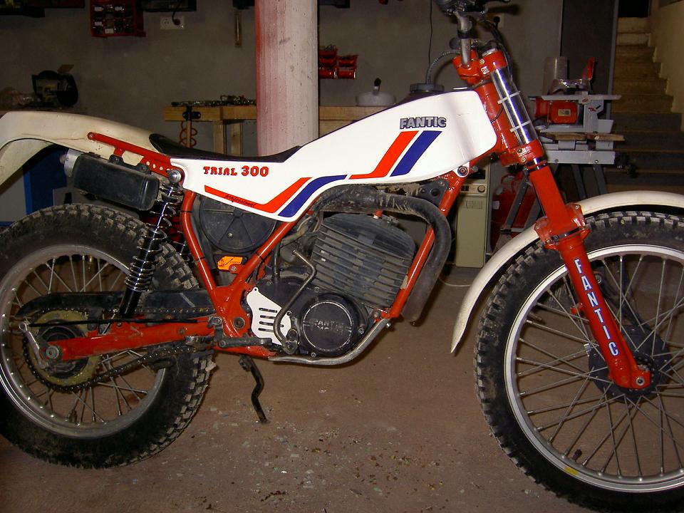

Thanks Lee! I did have the clutch mod on my 240 and will do it to the 300 too! This bike is mint, found out yesterday riding it that the odometer still works and it has 60 original miles on it!!!! :thumbup: No scratches on the skidplate either, not even broken in! Thing of beauty. Are the stock 300 rear fenders as rare as I have been told?? might change it to save it!

As soon as I can get a pic of her with digi camera I will post. Confirmation last night while riding it that the odometer does in fact work!!!! 60 original miles on it and now counting!!! Ordering up a 240 rear fender too!

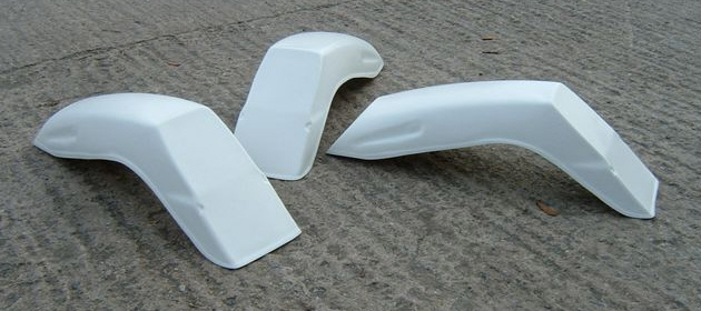

Yes steve, rears are unobtainium. i know a guy who has a couple but hes not giving them out off his hands!!! Chgange it!
Not any more.....just had these manufactured from vacuum formed plastic, send me a p.m. if you are interested.
