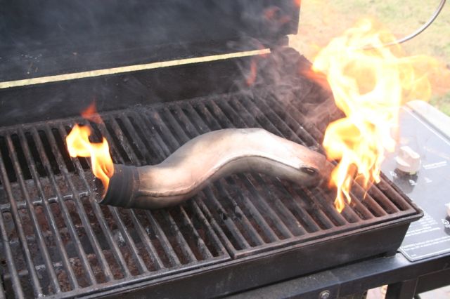

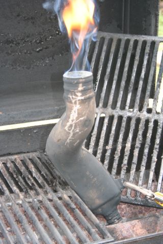

gregkabob Posted November 6, 2006 Report Share Posted November 6, 2006 Fire in the Hole..... Removed the center pipe, added a little lighter fluid and fired it up. Once it got going it burned for a good 20 minutes. Quote Link to comment Share on other sites More sharing options...
barrybaines Posted November 6, 2006 Report Share Posted November 6, 2006 Crazy stuff! looks fun and I can`t stop laughing at they pic`s! you`ll have too let us know if it made any differnce, Thing i`d worry about doing it that way is burning all the sound dampening out? Quote Link to comment Share on other sites More sharing options...
gregkabob Posted November 6, 2006 Report Share Posted November 6, 2006 I'll let you all know how it goes when I fire it up. I looked inside and it looked like the stuff was still in there. I couldn't find a caustic soda so a guy at the local shop said that's the way he does the MX bikes. Quote Link to comment Share on other sites More sharing options...
