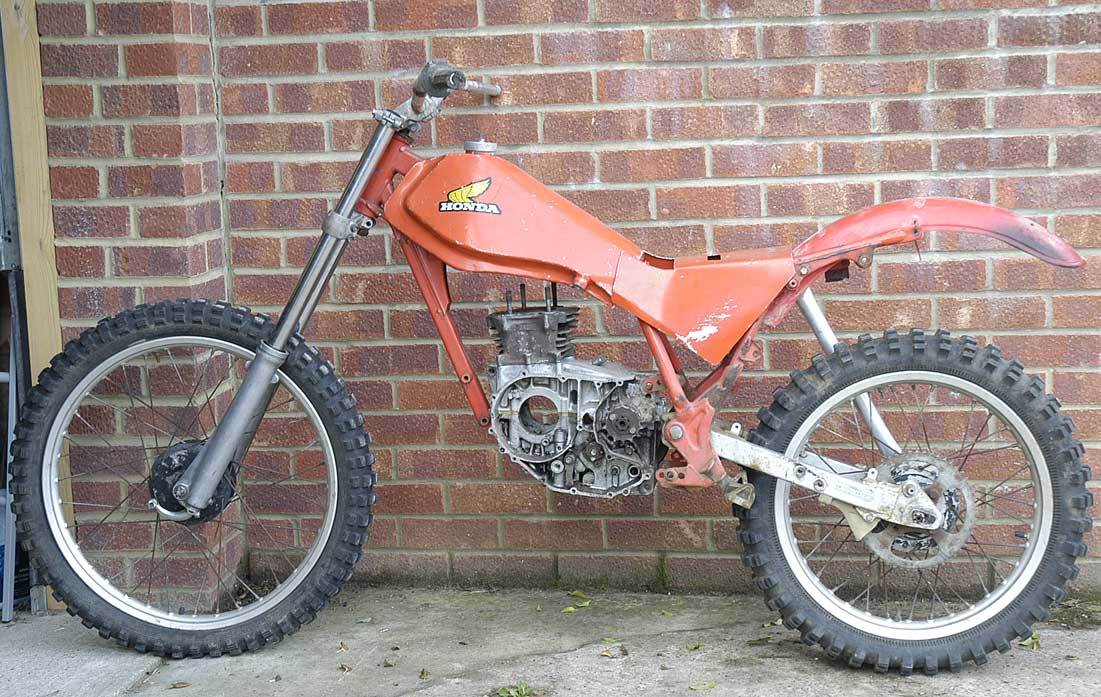

Here is my next project once the C15t is sorted.
Over the years I have built up a collection of spares for my TL250 and have ended up with virtually a whole bike except a frame.
Thinking that a slightly smaller lighter frame would make a rather nice TL I bought an RS200 frame, but would have had to chop it a lot which seemed a shame, so sold it and have bought a TLR frame, strangely the engine fits pretty well ( unlike the RS ) and just needs the lower mounts moving and a little fiddling to get the chainline right.
The forks are TL250, wheels are early Elsinore whilst the Tank is a custom alloy one, all the bits bought pretty cheaply (the wheels came with an Elsinore rolling chassis for
