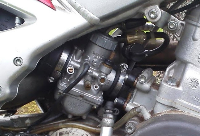

mecajental Posted June 19, 2011 Report Share Posted June 19, 2011 Hi. I would like to show the solution I have addopted to solve the leakage problems. There is no nedd to drill, and the mod is completely reversible. The little pipe is a brass ballpen refill. Is easyer to weld than stainless steel ones. I have modified two carbs, an there is no leackage, even with the bike at extreme positions. Regards 1 Quote Link to comment Share on other sites More sharing options...
