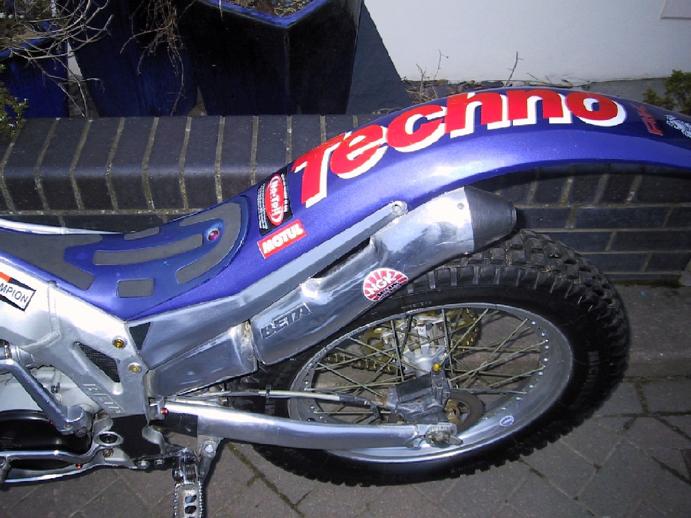

beta boy Posted March 25, 2004 Report Share Posted March 25, 2004 (edited) here is what i did it aint clear but it has a cable tie on it Edited March 25, 2004 by beta boy Quote Link to comment Share on other sites More sharing options...

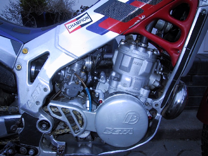

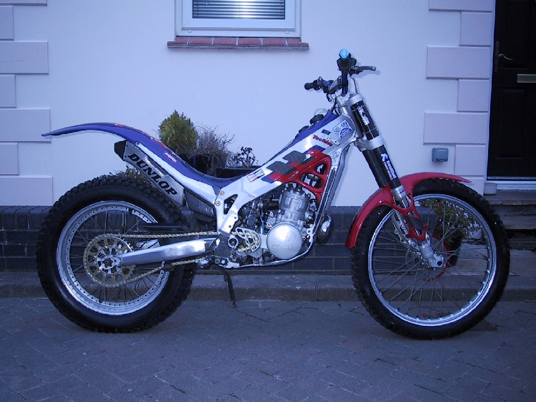

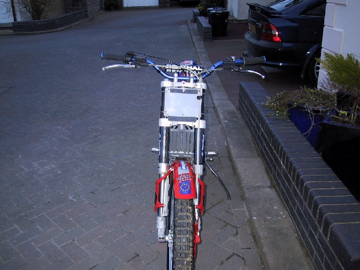

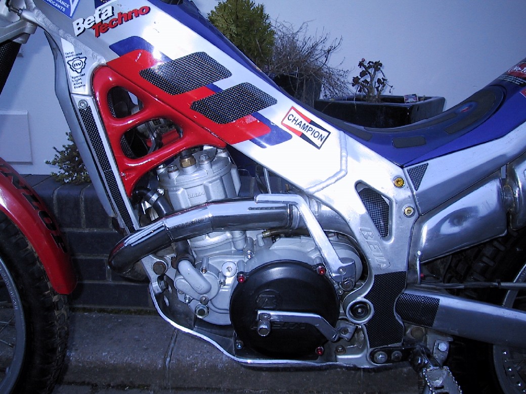

beta boy Posted March 25, 2004 Report Share Posted March 25, 2004 (edited) and he is the rest of my bike cause i wanna show anyhill Edited March 25, 2004 by beta boy Quote Link to comment Share on other sites More sharing options...
