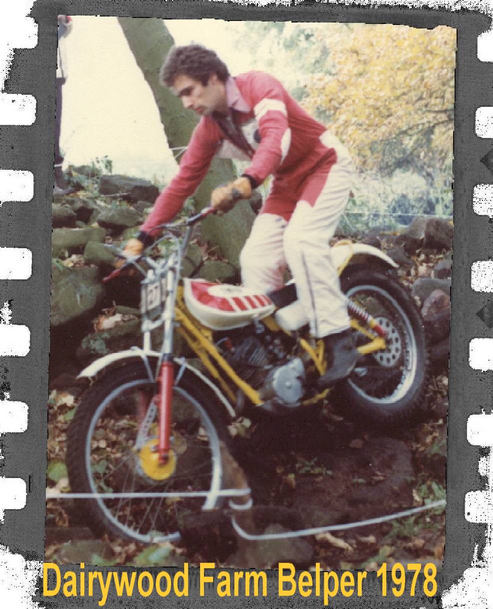

westyfield Posted January 5, 2007 Report Share Posted January 5, 2007 Back in 1978 my old mate Walt Keeling and I layed the shocks down on our TY175's as discussed and then John Shirt did his bit to the motors with 200 cc conversions and the bikes were transformed fom being just "OK" into "quite competitive".. untill the Fantic came along anyway!! (This was pre MAJESTY don't forget) The motor was amazing with the big bore conversion but the ride over rocks and the grip in mud were much better too, so I would say "go for it" Quote Link to comment Share on other sites More sharing options...
