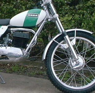

vinnied Posted January 10, 2007 Report Share Posted January 10, 2007 Does anybody no the ammount of fork oil that goes in this model of ossa This shot is belong to Twinshockdude i borrowed it just to show the model hope it is ok Vinnie Quote Link to comment Share on other sites More sharing options...
jaylael Posted January 10, 2007 Report Share Posted January 10, 2007 Six ounces of ten weight per side. JL Quote Link to comment Share on other sites More sharing options...
vinnied Posted January 10, 2007 Author Report Share Posted January 10, 2007 (edited) Thanks JL would you know that in cc Vinnie Edited January 10, 2007 by Vinnied Quote Link to comment Share on other sites More sharing options...
jaylael Posted January 10, 2007 Report Share Posted January 10, 2007 It's on the side of a baby bottle. Since I don't have one handy, I looked it up on internet. 1 us oz. = 29.57 cc so 6 X 29.57 = 177.42 Does that sound right? Maybe just get a baby bottle. JL Quote Link to comment Share on other sites More sharing options...
old trials fanatic Posted January 10, 2007 Report Share Posted January 10, 2007 I run 170cc 5W in mine with 45mm preload. Then again i am 1) a fat ******* 2) they are fitted to a B40 which is possibly a bit heavier than an OSSA However http://hem.passagen.se/ossa/ is a site that might be of help? 170cc works in my 199B also and they are Betor forks just the same as the OSSA but whatever. Quote Link to comment Share on other sites More sharing options...
woody Posted January 10, 2007 Report Share Posted January 10, 2007 The Bulto forks take a bit less oil than the Ossa (maybe due to the shorter legs?) Book recommends 200cc I think in MK1 or MK2 Ossa forks (as per bike pictured) I use 180cc generally with 10W as this gives a relatively soft action but as with most things it is all down to personal preference so you could use that as a starting point. The MK3 and onwards had longer forks so usually 200cc as a starting point for them. Quote Link to comment Share on other sites More sharing options...
vinnied Posted January 11, 2007 Author Report Share Posted January 11, 2007 (edited) I run 170cc 5W in mine with 45mm preload. Then again i am 1) a fat ******* 2) they are fitted to a B40 which is possibly a bit heavier than an OSSA However http://hem.passagen.se/ossa/ is a site that might be of help?170cc works in my 199B also and they are Betor forks just the same as the OSSA but whatever. Cheers Woody JayLael Cheers Old trials fanatic i 2 am a fat 16 stone ******* 2 Vinnie Edited January 11, 2007 by Vinnied Quote Link to comment Share on other sites More sharing options...
