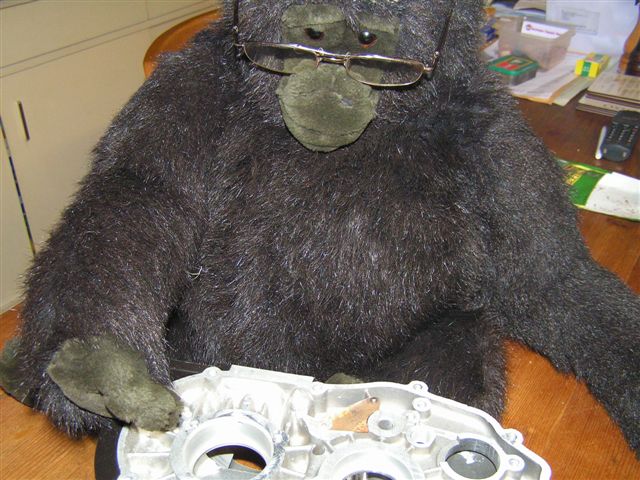

ask greeves Posted January 14, 2007 Report Share Posted January 14, 2007 (edited) I would do as Lee says on the magneto side oil seal, but on the clutch side i would remove the whole assembly, which is held on with 3 alan screws, also change the large outer o ring and the small inner o ring behind the inner spacer. The chief mechanic is pointing at where the oilseal and retainer is situated. Edited January 14, 2007 by ask greeves Quote Link to comment Share on other sites More sharing options...
