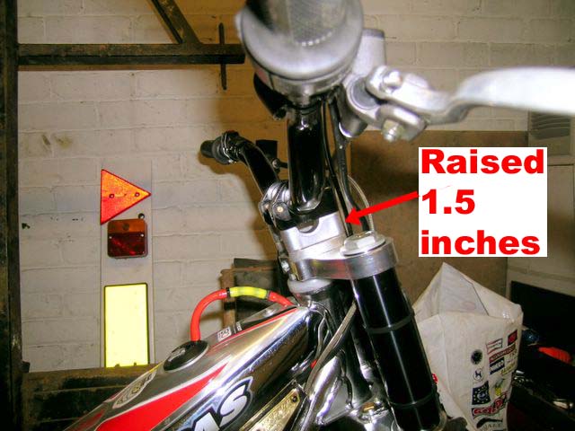

In a Mick Andrews video he made reference to a taller rider being slightly disadvantage with his height and he recommended higher bars. I'm not as tall as you but i raised my bars on my Gas Gas because i felt they were a little low - see picture below
Edited by spud
