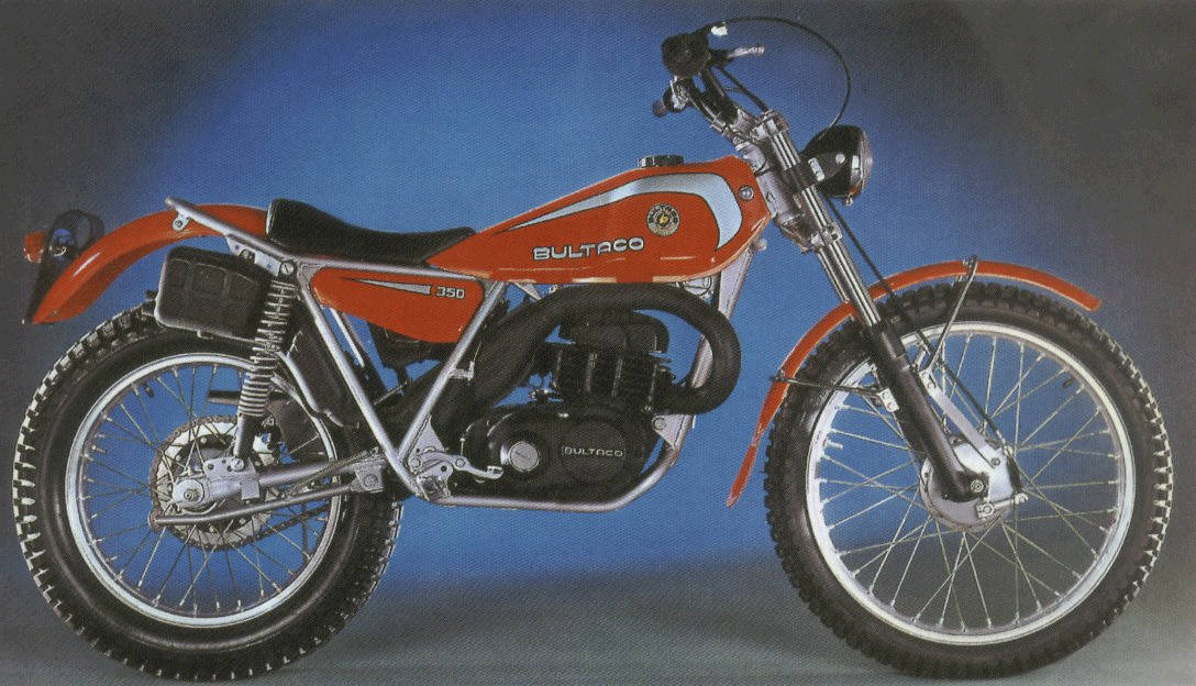

toofasttim Posted April 6, 2007 Report Share Posted April 6, 2007 (edited) Dave, the bike should look like this: The tank on yours is correct for the UK. Edited April 6, 2007 by TooFastTim Quote Link to comment Share on other sites More sharing options...

dave dix Posted April 6, 2007 Author Report Share Posted April 6, 2007 Thanks for the pics, my one is close with an ally tank but the engine bottomhalf is un-painted and it has the thru shaft for left or righthand change. Took it out today and it ran a bit 4 strokey until i popped the carb off my ty250 and put it on the sherpa and that done the trick!!!! it just pulled beautifully with a carb change even though i have cleaned out the mk2 anal sorry amal, very torquey lump Dave Quote Link to comment Share on other sites More sharing options...
