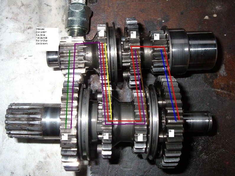

neo Posted May 5, 2007 Report Share Posted May 5, 2007 Does anybody know what GasGas mean by this..."Coaxial Selector of GAS GAS (patented)"... in their 07 bike specs? Best of balance. Neo Quote Link to comment Share on other sites More sharing options...
ikb Posted May 5, 2007 Report Share Posted May 5, 2007 (edited) Yes, Its a magic system that gives you 6 gears from 4 pairs of cogs! It means the pro engine is narrow and light and has a full 6 gears. Edited May 5, 2007 by IKB Quote Link to comment Share on other sites More sharing options...

hrc1 Posted May 10, 2007 Report Share Posted May 10, 2007 Does anybody know what GasGas mean by this..."Coaxial Selector of GAS GAS (patented)"... in their 07 bike specs?Best of balance. Neo It's the gear selector mechanism placed inside the selector drum - saves width. I'd post a pic, but can't seem to do that anymore... Quote Link to comment Share on other sites More sharing options...

hrc1 Posted May 18, 2007 Report Share Posted May 18, 2007 Found a way to post images now............ Neat design, saves width & weight, but tucked away in the engine's bowels, so if damaged full strip required. Quote Link to comment Share on other sites More sharing options...
