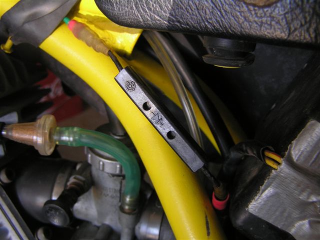

feetupfun Posted August 10, 2008 Report Share Posted August 10, 2008 Here is a picture of the diode used on Yamaha twinshocks to prevent the motor getting a spark when rotating backwards. This diode is from a 1977 TY250D Quote Link to comment Share on other sites More sharing options...
