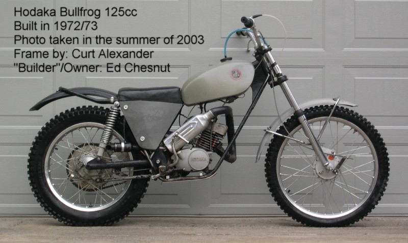

sendero Posted May 10, 2004 Report Share Posted May 10, 2004 Bullfrog, Give us the story on the Hodaka in your avatar. There are a few Hodaka enthusiasts here. Quote Link to comment Share on other sites More sharing options...

bullfrog Posted May 11, 2004 Author Report Share Posted May 11, 2004 Gents, I'm sorry its taken me so long to reply. I had some catching up to do after spending so much time keeping up on the progress of the SSDT (and Team WOFTAM). 30 days after hiring on with Hodaka Motorcycles in 1971, I took out a bank loan to purchase a Saracen 125 Trials. Those machines were quite impressive what with the light weight and precise steering. They needed better suspension, brakes and more tractable power - yet they were impressive. So much so that an idea was hatched to build a Hodaka powered version. You can see the ORIGINAL Bullfrog on the strictlyhodaka website in the scrapbook, just a few bikes down from the top. The original was actually built on a modified Saracen frame and had an R&D Dept. 150+cc engine with special trials transmission (close ratio 1, 2, 3 and a bit of a jump to 4 & 5). Several of us @ PABATCO were trials enthusiasts and watched the project closely . . . and ended up with a severe case of the "I've got to have one of those" willies. 5 (or was it 6?) custom frames were designed and jig built based on the Saracen geometry. Curt Alexander of the R&D Dept. built the frames. The deal was that Curt would do the building if the other's of us would purchase the materials and Curt would get a frame at the end. That was a true "win-win" situation! Curt finished the build out on his frame using a Cotton tank (like Leon Wilbanks' original) but with maroon paint. I believe he mounted a 125 engine - certainly with extra fly wheel weight. I know about the fly wheel weight because he made an extra weight for me. I finished my 'frog but, being about 24 or 25 at the time, the funds available for the machine AFTER beer, chasing girls and food, were quite limited. So my machine ended up with "economy" plastic fenders and tank (ie, free, scrounged from the nooks and crannies of Pabatco). The machine was parked (and garage buried) from about 1980 to 2003. In 2003 I dug it out (literally) and got it running again. What a hoot! General Specifications: 51.75" Wheelbase; 153 pounds (no fuel - 64 front, 89 rear); Model 94 Wombat lower end with Model 95 Combat Wombat top end with added reed valve; 24mm Mikuni; standard point ignition; extra 3.4 pounds of flywheel weight added to magneto side; 12 tooth or 13 tooth primary sprocket and 64 tooth final sprocket (generally prefer 12 tooth); lightly modified Wombat forks, 6.125" travel; Girling rear end, 4" travel; stock Hodaka hubs - older models, smaller dia. and weight - extended brake levers at hubs; 1.75" header pipe (1.5" replacement in progress now); Sammy Miller Muffler; Renthal bars; hand made seat, chain guard and air box. Since my beer "needs" have decreased somewhat in the last 30 years and since my girl chasing has been limited to one particularly wonderful woman since 1977 and that leaves only food as a "drag" on my ability to obtain neat goodies for the Bullfrog now - I've started collecting some items to build it up the way it really deserves. I've got a Cotton tank to clean up, repair and paint! Bob Ginder helped me pick the right alloy fenders for installation front and rear. . . . and plots are afoot to re-do the exhaust system, chain tensioner and airbox. Thanks for asking about the scoot Sendero! It's pretty obvious I'm (re) excited about it, isn't it? Bullfrog Quote Link to comment Share on other sites More sharing options...

jaylael Posted May 12, 2004 Report Share Posted May 12, 2004 Hey Guys: I did a bit of research and came up with the name of the guy who rode his Wombat from New York and a page with some pics etc. Here's the address to the web page for Steve Kirkpatrick's ride. www.jhmand.com/hodaka/steve.html That was a brave attempt at crossing America on a Wombat! Also a comment about Ed's Bullfrog. It works way better than mine. Maybe the new one will be closer though. Jay L. Quote Link to comment Share on other sites More sharing options...
