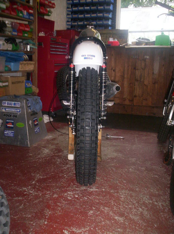

sir trial a lot Posted July 18, 2007 Report Share Posted July 18, 2007 It took me ages to get my rear wheel right. Getting it correctly spaced etc. on the hub, getting it central to the steering head and many other things had to be checked. As you say it does sit nearer to the right hand shock to the left. Mine does too but the actual wheel sits central in the swingarm. Here is a picture i took of mine for you. Hope this is of help Quote Link to comment Share on other sites More sharing options...
vinnied Posted July 18, 2007 Report Share Posted July 18, 2007 (edited) sir trial a lot said: It took me ages to get my rear wheel right. Getting it correctly spaced etc. on the hub, getting it central to the steering head and many other things had to be checked. As you say it does sit nearer to the right hand shock to the left. Mine does too but the actual wheel sits central in the swingarm. Here is a picture i took of mine for you.this might be easier Vinnie Edited July 18, 2007 by Vinnied Quote Link to comment Share on other sites More sharing options...
