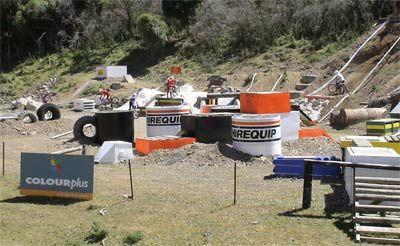

mostar Posted September 15, 2007 Author Report Share Posted September 15, 2007 Hi Mostar,Not exactly the reply you are after, but(!), hope you could help. My other half has got it into her head she wants to emigrate to NZ and we're really interested in the Nelson area - my only concern - are there many trials happening around there or do you just practice then travel etc??? Any help would be really appreciated. Thanks, Nick Hi Nick , Once you come here you wont go back , Nelson has a good club & Nelson has the most sun shine hours in the hole of NZ , So if you like wet club trials dont come here , LOL . On top of all that we have one of the best trials park in the world , Club days once a month & you can practice at the park when ever you like , Just a donation for maintance at the park , Hope this helps , Cheers Karl Quote Link to comment Share on other sites More sharing options...

mostar Posted September 15, 2007 Author Report Share Posted September 15, 2007 (edited) Nick , Check this out http://www.nonstopadventure.co.nz/ , Thanks to all the replys Guys Cheers Karl Edited September 15, 2007 by mostar Quote Link to comment Share on other sites More sharing options...
nickc Posted September 16, 2007 Report Share Posted September 16, 2007 Nick ,Check this out http://www.nonstopadventure.co.nz/ , Thanks to all the replys Guys Cheers Karl Hi Karl Thanks mate, a real star! Well no need to worry there then! Going to give Nonstop an email and see if I can get a days riding in while i'm out there. Thanks again for your help, really appreciated. Nick Quote Link to comment Share on other sites More sharing options...
mostar Posted September 16, 2007 Author Report Share Posted September 16, 2007 Hey Nick No worries , You would be very welcome in sunny Nelson NZ . Drop Steve a line at Non Stop & he will be more that glad to help you out , Thanks Karl . 8>) Quote Link to comment Share on other sites More sharing options...
