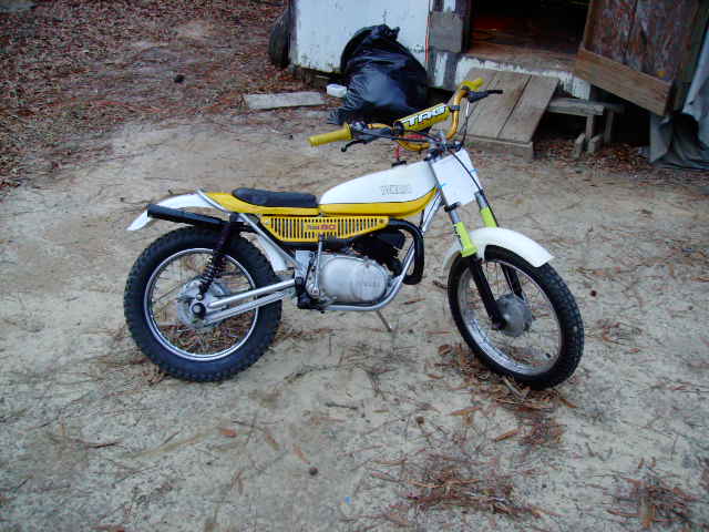

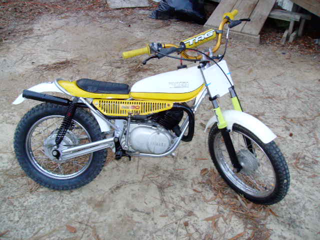

:o After my getting the clutch as easy as I could at present , I taught my little one how to ride his "new" bike ...
1; clutch to stiff for small hands !
2 ; Stock throttle (and oe slide spring ) too light ...
3 ; Dads porting and expansion chamber de baffling , extra OOMMPHH ! (will lift the front end in 3rd gear on it's own w/my 200lbs on the seat !)
4 ; Trying to pull in clutch to stop (like DaD told him !) , jerks throttle WFO too ... and crashes into house...
5 ; big ole tear rolling down cheek and first words " is MY bike ok ? " and I have to say , Bike is fine , your not broke , and you will never forget your first good crash :thumbup: (house dented ! )
So I've got a slow turn throttle on the way , some adjustable pivot levers , and I'll put in the new oe. spark arester/silencer guts I've got .(just to mellow it a bit ...) But what a ball the little beastie is to ride ..
6 ; And the look on his face as he made his first lap around the yard on his own ... PRICELESS !!!!!

Thats not the problem ... He's strong as a baby OX , the lever is on the stiff side for me too ... I used some stubby honda mx levers I had around 'cause the stock ones are trash . And there is just enough differance in the fulcrum of the levers to make a world of differance on the ty80 type clutch linkage ... ya know DAD's cheap so we run what we've got !!!! and I've got all kinds of stuff .... :thumbup:
Will post again after mods to the bike ...
And I already have to keep it locked up !
Glenn :o
You can see how short the levers are in the photo , I think they were for a early elsinore !?...

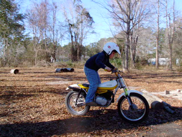

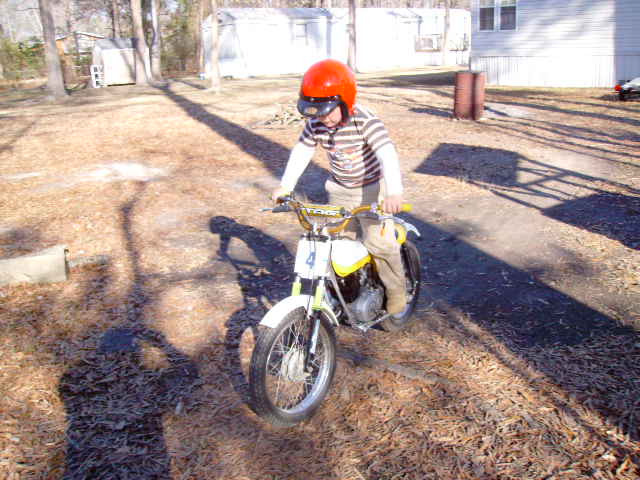

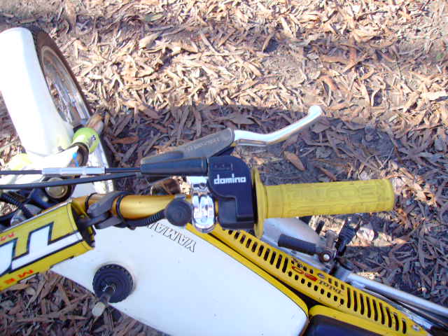

:rolleyes: Some small details make all the differance ! adjustable levers , slow domino , (with throttle stop , Trial and error process , but well worth the time !) And a little boys confidence in himself and bike quadruple in minutes !

Glen, B&J has some good 3 position levers at a good price and MSR also sells some good 3 position ones.
Not that good for modern style clutch riding but good for learning. I used a teather kill switch when my son was learning. Get some proper grips while your at it, tight wad! :unsure: What, are you from Scotland? ( I hope Big John doesn't read this) :rolleyes:
