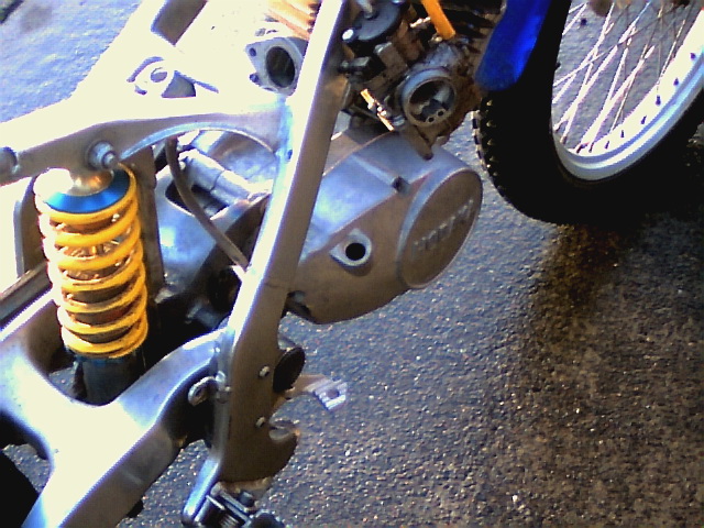

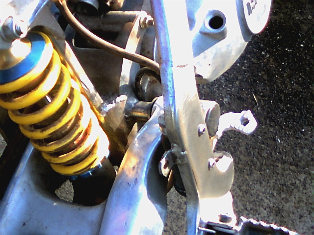

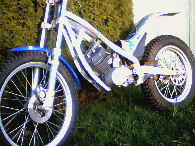

jaylael Posted February 9, 2008 Author Report Share Posted February 9, 2008 As Benny Hill once said, "Well, here 'tis"! Quote Link to comment Share on other sites More sharing options...
vintagecota Posted February 9, 2008 Report Share Posted February 9, 2008 That looks amazing, Jay. I'm an engineering type, not an Engineer but a technologist and I build highrise towers, so I have an eye for what works structurally. That said, I don't think the front subframe is going to be highly stressed anyways, because that steel gusset welded between the steering head and the underside of the frame looks like it's going to do most of the job by itself. One question though. Where does the carb go? LOL Quote Link to comment Share on other sites More sharing options...
zippy Posted February 9, 2008 Report Share Posted February 9, 2008 I just like to see how things are built and how they work. That looks really nice, I like the swingarm mount looks mighty strong. Motor fits in there really nice. Is that Sherco frame a year 2000? The rear skidplate mounts look just like my 2000's and there appears to be a crack in the one. (just like mine) I ended up welding an extra plate to the inner side of the mounting tab and a gusset from the round part of the frame to the tab. (yep explanation clear as mud) When I get everything else together (big winter project) I will test them out. Read as "beat the hell out of them" Quote Link to comment Share on other sites More sharing options...
jaylael Posted February 9, 2008 Author Report Share Posted February 9, 2008 Yeah, Zip, it's a Y2k. Need to build carb manifold, header pipe, skid plate etc. Also need to rest. This bit of progress came at a price to my constitution. Moving forward in fits and starts but darn good progress. I think this thing will work incredibly good for a Hodaka. Yep, it's a busted skid plate mount allright. Good tip on the extra plate. I may do that one too. Thinking about ways to isolate the skid plate on rubber grommets or something way more advanced than just bolting it on. Rubber pad creates difficulty removing and installing the side cases. I plan on using a piece of 5/16" alloy plate, sheared to size and bent on a press brake. Rubber mounts at the corners would provide a cushion to the tremendous shocks imposed upon the skid plate by typical thrasher trials riders like myself. Unlike the factory stars we country folk could do with a bit of shock absorbtion at the skid plate. Rubber bushed mounting is something I want to do. The mental scratch pad is back in action. Jay Quote Link to comment Share on other sites More sharing options...
