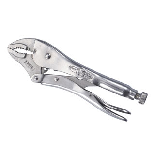

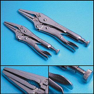

dfwilson Posted February 13, 2008 Report Share Posted February 13, 2008 Have you tried using a set of Vice Grip pliers? These will bite into the metal and twist the bolt loose. Another approach is to use a small grinding wheel and re surface the bolt flats. Good luck DFW Quote Link to comment Share on other sites More sharing options...

andat Posted February 13, 2008 Author Report Share Posted February 13, 2008 Have you tried using a set of Vice Grip pliers? These will bite into the metal and twist the bolt loose. Another approach is to use a small grinding wheel and re surface the bolt flats.Good luck DFW Tried this, but it just seemed to make the rounding on the bolt head worse. There isn't a lot of space to get the molegrips in. I might try the grinding wheel (Dremmel) if the undersize socket approach doesn't work. Thanks anyway. Quote Link to comment Share on other sites More sharing options...
