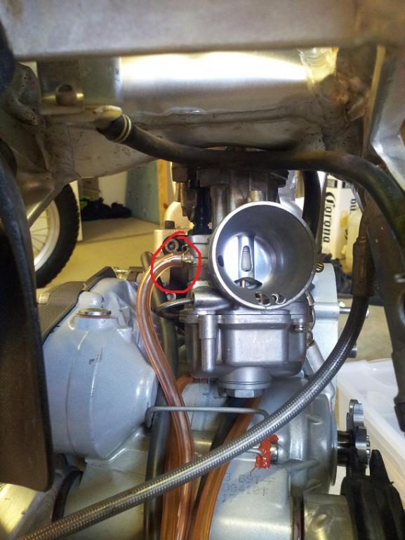

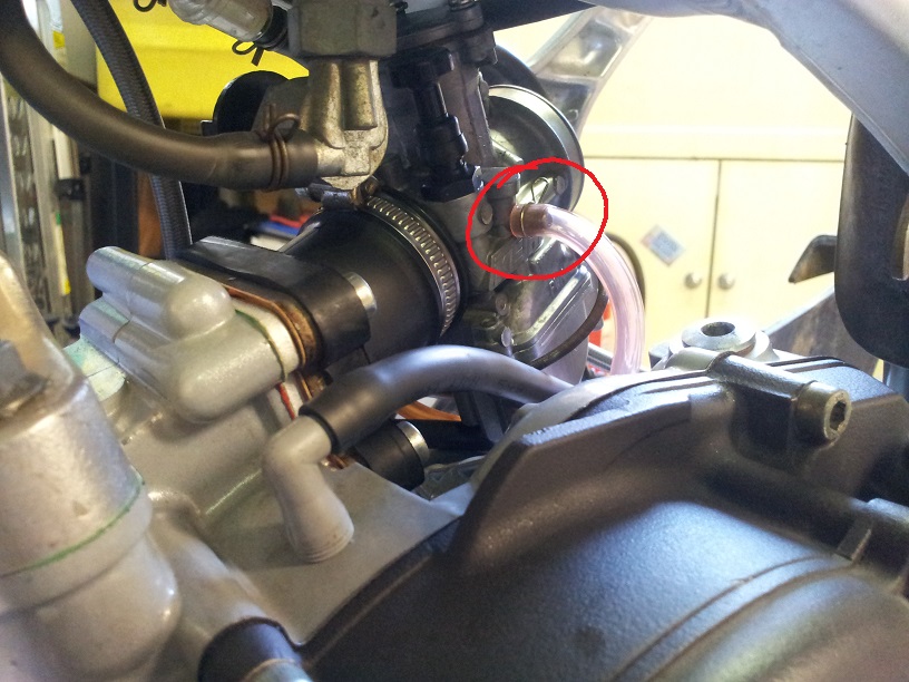

worldtrialchamp Posted December 14, 2013 Report Share Posted December 14, 2013 The Keihin PWK28 fitted to modern trials bikes has only one atmospheric port open, the other one is blanked off by the casting. I have done this mod to several bikes fitted with Keihin PWK28 carb. It stops the bike gagging when at extreme angles eg splatters, steep descents On the LHS of the carburettor, the vertical atmospheric port inside the float bowl area is pre cast by Keihin but the horizontal port on the LHS is blanked. Just drill it out with a 2.5mm drill until it meets the existing vertical port (you'll feel it) 1 Quote Link to comment Share on other sites More sharing options...

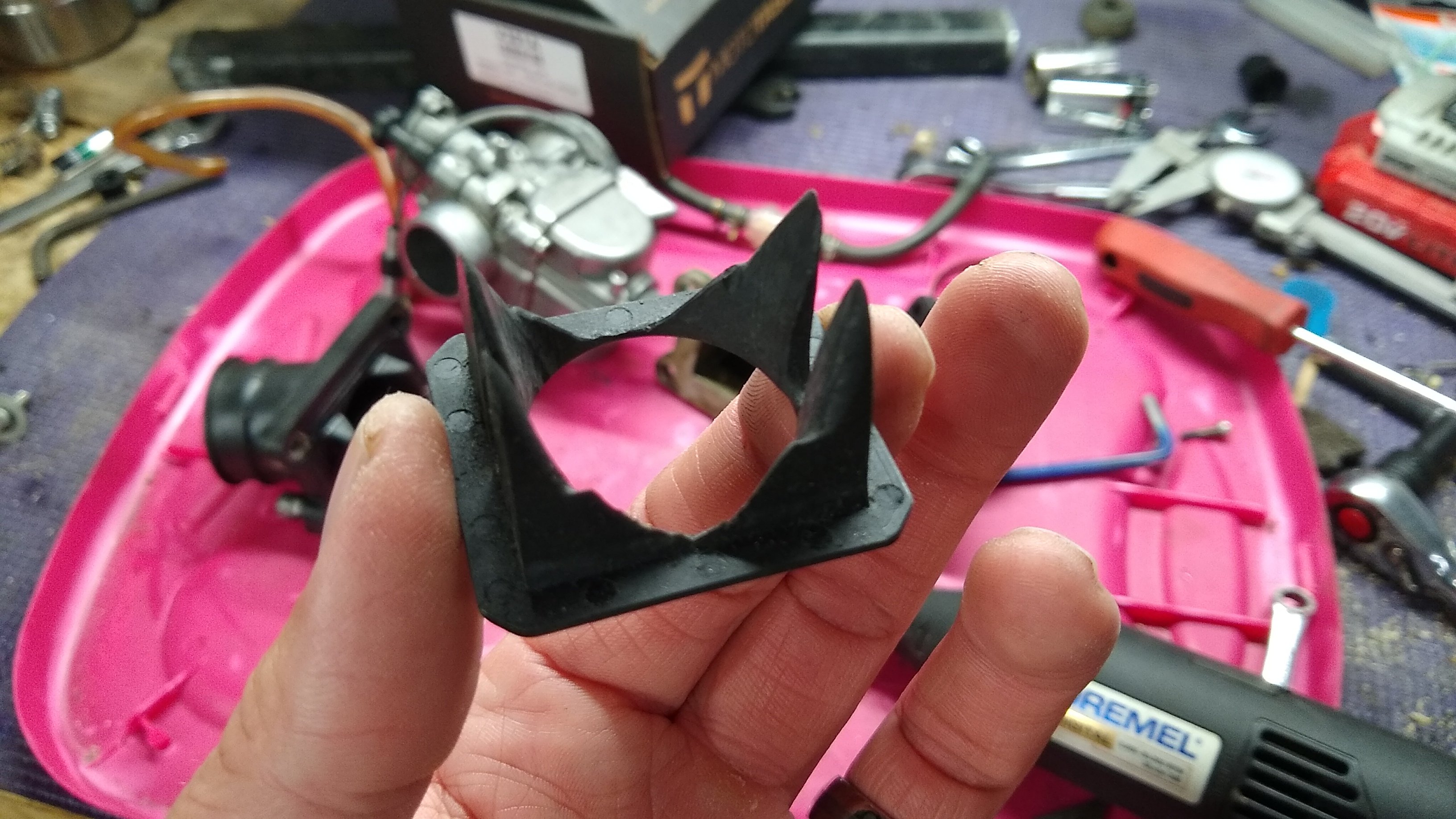

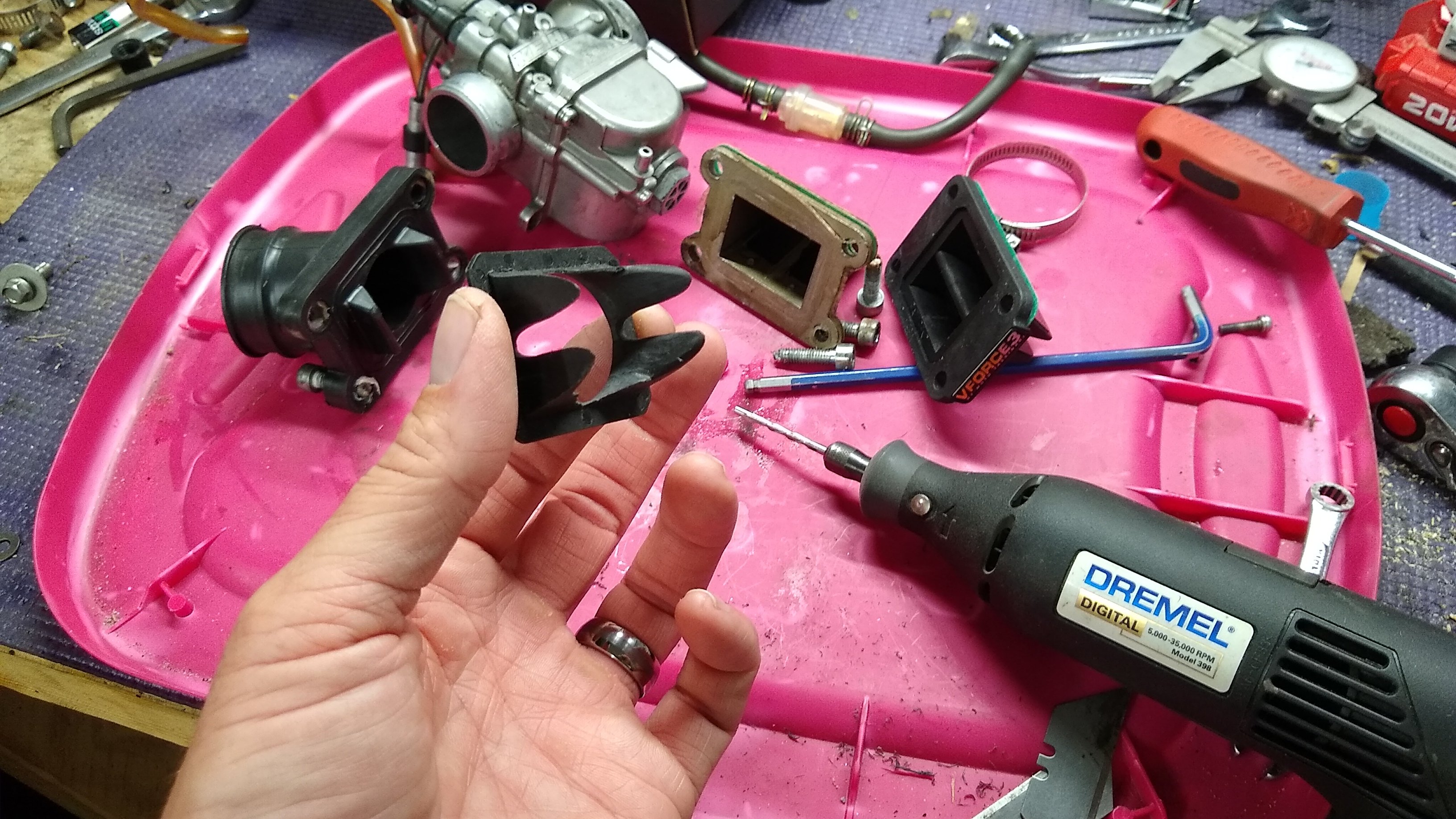

dan williams Posted May 26, 2020 Report Share Posted May 26, 2020 Very familiar with the '08 engine. It was probably my post on the VForce reeds. I just ground the protrusions from the face of the Beta manifold and opened up the VForce insert a bit. I've run my Zero's Technos, Rev3s and EVOs on 80:1 to 100:1 on BelRay H1R for years without problems. At 50:1 the mid-muffler and silencer could be pretty gummed up. The transition from pilot to needle goes through the slide cutaway but I don't think that's your problem. The stock jetting for the '08 was pretty close and I think the JHL or JJH needle was stock. I can't remember. One thing to consider is Beta's have high compression engines and really like their octane. They'll usually run mediocre on pump gas. Some will just jet them richer and consider it a job done but it really doesn't solve the problem. An '08 could be due a set of rings. The degradation as the rings wear is so gradual you usually won't even notice but it will lose some of the bottom end and starting will suffer. Also leaks in the intake tract can make the bike somewhat boggy so a shot of starting fluid around the manifold while the bike is running will change the engine note with a leak but I get the impression you know that. WD40 used to work but they changed the propellant from propane to something non-combustible so it doesn't have quite the same effect. When my carb needs a clean I'll usually pull the center tower off. Needs a torx security bit. I forget the size. T20 I think. Trying to diagnose over the internet is such a drag when I'd rather be up to my elbows in an engine or at least be able to hear it in person. Quote Link to comment Share on other sites More sharing options...
