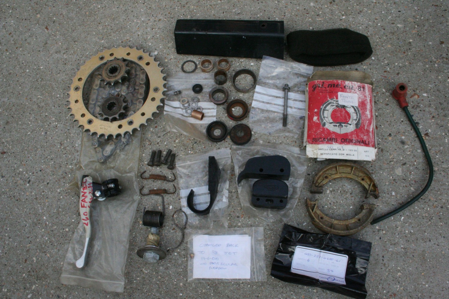

spud Posted May 3, 2008 Author Report Share Posted May 3, 2008 (edited) Thanks. When i bought the bike i was given a box with some bits in it. Just had a look in the box and below is what is there, not a lot. I'm interested in your thoughts on the hand drawn diagram of the ignition. I think looking at the parts the carb has had a smaller main jet and the ignition retarded. Looking at the parts picture does anyone know what all the washer and nit bits are for. The paper work picture is minus the Bill Of Sale. It was bought from someone in Wiltshire for Edited May 3, 2008 by spud Quote Link to comment Share on other sites More sharing options...

spud Posted May 3, 2008 Author Report Share Posted May 3, 2008 (edited) I took the carb off and noticed the main jet was 44 (not 95) i'm definately thinking the ignition has been retarded. Bike will have the flywheel taken off tomorrow. I also made some enquiries and found out the engine had Edited May 3, 2008 by spud Quote Link to comment Share on other sites More sharing options...
lee harris Posted May 4, 2008 Report Share Posted May 4, 2008 (edited) Hi Spud, std jets are 45 and 98 main (you sure the 44 was main not pilot?) A std 240 will run better on 44 and 95 if you are not running long road sections. If so then go to 98 as std. The expansion chamber has fibre glass packing which will be all gued up after so many years so go down slightly on jets. Cleaning it with caustic soda might help you...it didnt me. You can try playing with the ignition but it doesnt seam to make a lot of difference. Power delivery with motoplat is softer than dansi. The french guy, fantic club president chris darras says to add a head gasket to soften with dansi. i left mine alone. Some interesting spares...kickstart spring which means engine split and oil seals for the crank = dito @bilco. Sun Inn is on for me. You can tell me about the spain trial there. I have a fiver on each days points and another 10er on the total results......should pay towards either your or my beer.... Edited May 4, 2008 by Lee Harris Quote Link to comment Share on other sites More sharing options...

spud Posted May 4, 2008 Author Report Share Posted May 4, 2008 (edited) Lee Harris said: Hi Spud,std jets are 45 and 98 main (you sure the 44 was main not pilot?) A std 240 will run better on 44 and 95 if you are not running long road sections. If so then go to 98 as std. The expansion chamber has fibre glass packing which will be all gued up after so many years so go down slightly on jets. Cleaning it with caustic soda might help you...it didnt me. You can try playing with the ignition but it doesnt seam to make a lot of difference. Power delivery with motoplat is softer than dansi. The french guy, fantic club president chris darras says to add a head gasket to soften with dansi. i left mine alone. Some interesting spares...kickstart spring which means engine split and oil seals for the crank = dito @bilco. Sun Inn is on for me. You can tell me about the spain trial there. I have a fiver on each days points and another 10er on the total results......should pay towards either your or my beer.... Your right I was looking at the main pilot jet and got a little mixed up. The jetting is standard. I inspected the timing after removing the flywheel and all is good. The seal on the choke is perished and the throttle slide has some scoring around the bottom of the slide. I cleaned the carb and reassembled it. I set the air screw to 2 and a quarter turns out. After the iniational warming up the bike would not idle, well not until the idle screw had been turned in nearly all the way. When the bike was ticking over i noticed when i blipped the throttle it would take about 3 seconds for the engine to settle to idling. As a don't know what this bike should run like does this sound okay? If the carb is worn out does anyone have a replacement and a price? The Intake rubber from the carb to the engine looks in good order as too does the hose from the air box to the carb. The previous owner mentioned it didn't have much power and had problems driving up longish hills. This does not ring true from my observations of twinshock Fantics. My next port of call will be to inspect the exhaust for carbon build up. The engine does sound nice i've not ridden the bike as of yet. I noticed the front sprocket has 11 teeth but my spare set has 12 so the down of power theory could be correct. Edited May 4, 2008 by spud Quote Link to comment Share on other sites More sharing options...
