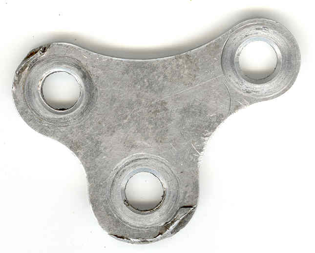

bulltaco Posted August 13, 2004 Report Share Posted August 13, 2004 I'm beginning to wonder if the delta plates on my 03 Mont might have been wrongly fitted at some time!. The handbook pics aren't very clear, can somebody put up a drawing or something showing the right fitting?. This scan shows the right hand side of the right hand Delta plate, ie the eye on the right fits the suspension unit. I wonder if it's been upside down?. I reckon that if they were turned up the other way it would raise the back end quite a bit?. I saw a pair of Jitsie deltas in a plastic bag but can't see a great deal of difference and in fact if they were fitted like the present ones it looks like they would actually drop the back end, which is where I started on this thread!. Quote Link to comment Share on other sites More sharing options...
jrsunt Posted August 13, 2004 Report Share Posted August 13, 2004 it looks as though they've fitted incorrectly, you should only have 1 edge battered by rocks, I cant tell you which way round off the top of my head, i'm finishing my bike off tonight for the brit champs, will have a look and let you know. Quote Link to comment Share on other sites More sharing options...
bulltaco Posted August 14, 2004 Report Share Posted August 14, 2004 Problem solved. After sussing out another Mont. it's clear that the previous owner has had the delta link apart at some time and refitted the plates upside down and on the wrong sides, which accounted for the bikes drooping rear and bottoming suspension. All working like it should now with new needle roller bearings as well (at Quote Link to comment Share on other sites More sharing options...
