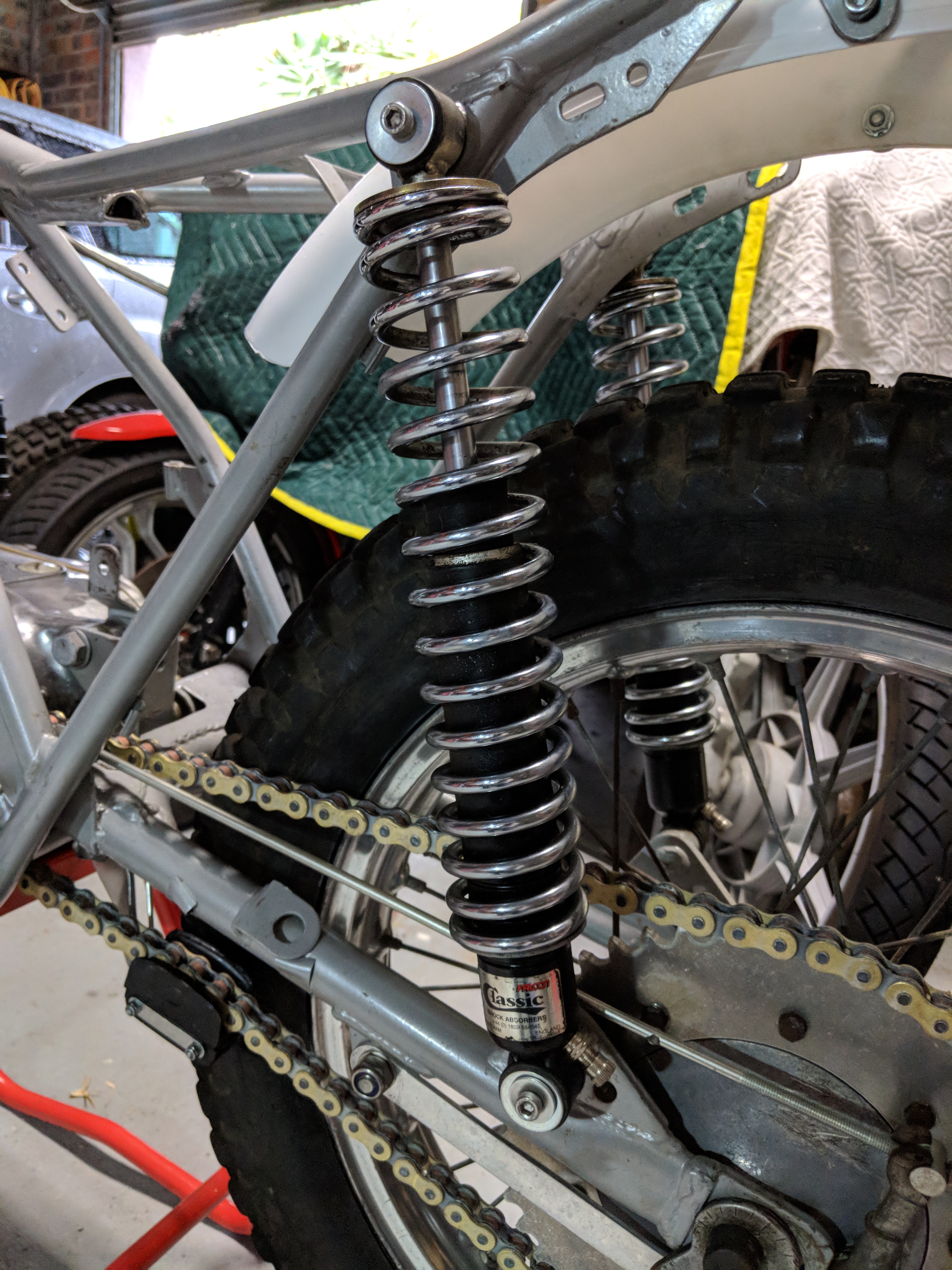

cornishflyer Posted June 9, 2018 Report Share Posted June 9, 2018 Sorry to revive this old thread but I have related question. I have a set of falcons on my Sherpa that need rebuilding, having no damping. They came with the bike I am restoring. Before I go to that effort I thought I would ask if anyone knows if these look like trials or MX shocks, as they are very stiff (even for MX really). They have no markings or model numbers that I can see on them. I don't want to go to the effort of servicing them if I can't use them on the bully. Cheers Quote Link to comment Share on other sites More sharing options...
feetupfun Posted June 13, 2018 Report Share Posted June 13, 2018 On 6/9/2018 at 1:54 PM, cornishflyer said: Sorry to revive this old thread but I have related question. I have a set of falcons on my Sherpa that need rebuilding, having no damping. They came with the bike I am restoring. Before I go to that effort I thought I would ask if anyone knows if these look like trials or MX shocks, as they are very stiff (even for MX really). They have no markings or model numbers that I can see on them. I don't want to go to the effort of servicing them if I can't use them on the bully. Cheers They look like Falcon Classic steel bodied Trials shocks and they may have no damping because they are fitted upside down. Try them the other way up before doing anything rash. You can get Falcons made so that they will work up that way, but standard Falcons only work properly the other way up to yours in the photo. The spring rate is usually engraved on the end of each spring in pounds/inch. If they are trials springs they should have 40 or 50 engraved. You will need to remove a spring to be able to read the engraving 1 Quote Link to comment Share on other sites More sharing options...
cornishflyer Posted June 13, 2018 Report Share Posted June 13, 2018 Thanks feetupfun. I got an email from Robin at Falcon. It turned out these are MX shocks with 80 engraved on the springs which is way to heavy for my weight on a trails bike. Ne did say I had them on the wrong way around but that didn't help the damping. I'm on the look out for another set I think. Cheers Quote Link to comment Share on other sites More sharing options...
