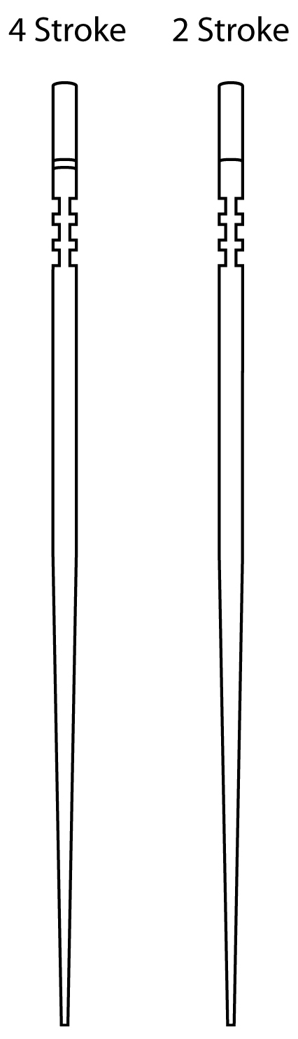

nigelog Posted May 5, 2008 Report Share Posted May 5, 2008 Hi, in a previous listing I saw reference to the difference offered with amal carbs of a 2 stroke and a 4 stroke needle. On tinkering today, dont know why as runs like a hamsters heart, albiet if hamsters suffer that vibration at low revs i dont think they could walk straight, i noticed that needle has 1 identifying groove above the clip setting grooves. In Rupert Ratios book this identifies it as a 2 stroke needle (4 stroke 2 identifying grooves). Someone mentioned that the 2 stroke needle is shorter, would this meam or explain C15 with 622-301 running rich not getting the metering of the longer needle at higher revs or am I looking at worn parts anyway. Only info I can get on 64 engine suggests they were fitted with monobloc so if anyone can advise needle/jets and whether a chrome slide is an advantage it would be much appreciated. Also, small thing but if i have oil stain around kickstart and gearlever shafts on a distributor model is it due to case holding too much oil or can oil just creep along these shafts after use. Need to know whether to buy a gasket and allen keys to find out. Any help appreciated. rgds nigel Quote Link to comment Share on other sites More sharing options...
superhondaman Posted May 31, 2008 Report Share Posted May 31, 2008 2 rings = 4 stroke 1 = 2 stroke as confirmed today by Triumph specialist Supreme M/c Quote Link to comment Share on other sites More sharing options...
vinnied Posted June 9, 2008 Report Share Posted June 9, 2008 Is this right superhondaman Vinnie Quote Link to comment Share on other sites More sharing options...
superhondaman Posted June 13, 2008 Report Share Posted June 13, 2008 Yes and when shown the 2 needles the 2 t one was shorter Quote Link to comment Share on other sites More sharing options...
nigelog Posted June 16, 2008 Author Report Share Posted June 16, 2008 Sorted, changed needle to 4 stroke type and re jetted carb. Thanks for clarification. Rgds Quote Link to comment Share on other sites More sharing options...
