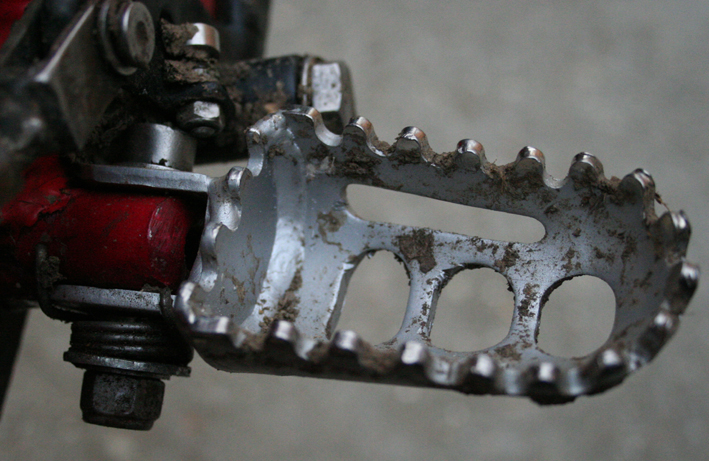

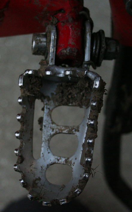

lee harris Posted June 16, 2008 Author Report Share Posted June 16, 2008 Thanks for the info. I put the std dellorto back on and the bike runs fine so I will look at the float. @spud. Did you fitt modded beta pegs to the 240 yet? Can yer post a detailed piccies or two? Thanks leee Quote Link to comment Share on other sites More sharing options...
spud Posted June 16, 2008 Report Share Posted June 16, 2008 (edited) Thanks for the info. I put the std dellorto back on and the bike runs fine so I will look at the float.@spud. Did you fitt modded beta pegs to the 240 yet? Can yer post a detailed piccies or two? Thanks leee The original pegs still fit, photo's were taken after win......next win will be a centre level when the new shocks arrive.....but the big test comes this weekend with the centre team trial. This event has experts of british national level riding one route which i'll be riding. The course will be a good intermediate centre level so the experts should go clean. i want to shame as many guys on modern bikes as i can .....competitive i can and will be! .....i rode my rev3 on sunday at a club event and hand on heart the fantic is helping me with my riding the beta with balance and hopping, both require a little more effert on the Fantic (not a lot) but this little extra effort is rewarding me. I've got my original carb for the Fantic but its definately not going back on the bike. Edited June 16, 2008 by spud Quote Link to comment Share on other sites More sharing options...
