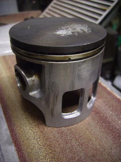

madcr500 Posted June 29, 2008 Report Share Posted June 29, 2008 'Ello Peeps. I know its not a trials bike but hope you dont mind. My neighbour has just brought me his DT175 which had lost compression. He has been lucky really. His piston rings disintegrated but it must have happened as the piston passed down accross the exhaust port as all the bits went into his exhaust. The bore is absolutely fine. I noticed that the piston is 0.25 oversize. Is this the first oversize? It needs a top end gasket kit, Little end bearing (old one is fine but might as well) and a piston kit. He wants to go for a weiseco kit and i agree if the cost isnt that much different (I'll ring weiseco tomorow). So where is the best place to get the gasket kit and get the price for a genuine yamaha piston kit? Also, is this the same piston kit as for a TY175? Does anyone have a manual for the DT175? If so what are the torque specs for the top end? One last thing, Are these gaps in the back of the piston standard or are they some kind of upgrade the last time it was bored? (see picture) Thanks for your help. Marcus Quote Link to comment Share on other sites More sharing options...

roxer Posted June 30, 2008 Report Share Posted June 30, 2008 Cheers steve. They have the piston kit in stock.Was yours ok? What make are the pistons. I dont suppose you have a manual do you? If so. could you look up a couple of things for me? It looks the same as the original and yes the holes in the piston are ports for gas exchange which I also have in my bike. I also have the manual somewhere which is for the twinshock and early monos but still is very handy as the engines changed so little. Steve Quote Link to comment Share on other sites More sharing options...

twinshockdude Posted June 30, 2008 Report Share Posted June 30, 2008 be very careful with pattern pistons,some need much more bore clearance. i have seen one seize up after a few minutes running,some seem to expand far more than genuine pistons. Quote Link to comment Share on other sites More sharing options...
