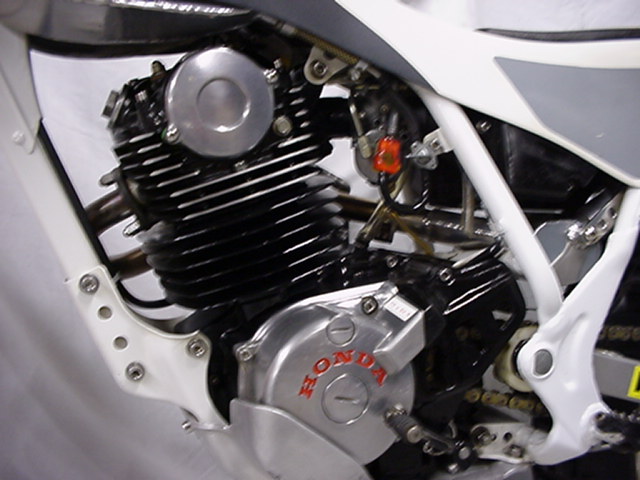

mcman56 Posted August 31, 2004 Report Share Posted August 31, 2004 Are aluminium skid plates still available for a Reflex (TLR200). I would like one like those on the TLR250. Quote Link to comment Share on other sites More sharing options...
t-shock 250 Posted August 31, 2004 Report Share Posted August 31, 2004 The one's on the TLR 250 aren't really good enough for the job,you need to modify them so they actually protect your valuable side cases. Like this........... Quote Link to comment Share on other sites More sharing options...
t-shock 250 Posted August 31, 2004 Report Share Posted August 31, 2004 Other side....... Quote Link to comment Share on other sites More sharing options...

mcman56 Posted September 1, 2004 Author Report Share Posted September 1, 2004 That is a beautiful skid plate. I have been trying to figure out how to make one like that but is seems none too easy. I have heard you can get Aluminium 6061 T0 that is pretty easy to work. It also seems like a hydraulic press with some type of wood forming dies may do the trick but it is still unclear to me. I'm a fair machinist but have no sheet metal experience. Can you let me in on the secret? How do you get alll of those shapely curves in 1/4" Aluminium? Quote Link to comment Share on other sites More sharing options...
t-shock 250 Posted September 1, 2004 Report Share Posted September 1, 2004 It's no secret, just use the existing guard, then cut some bits of card to the shape you want to extend. Then **** some alloy to the shape of the card templates and get someone to TIG them on, then file smooth! Quote Link to comment Share on other sites More sharing options...

mcman56 Posted September 2, 2004 Author Report Share Posted September 2, 2004 That brings me back to the original question. Where do I get one of the Aluminium skid plates to start with? Thanks! Quote Link to comment Share on other sites More sharing options...
