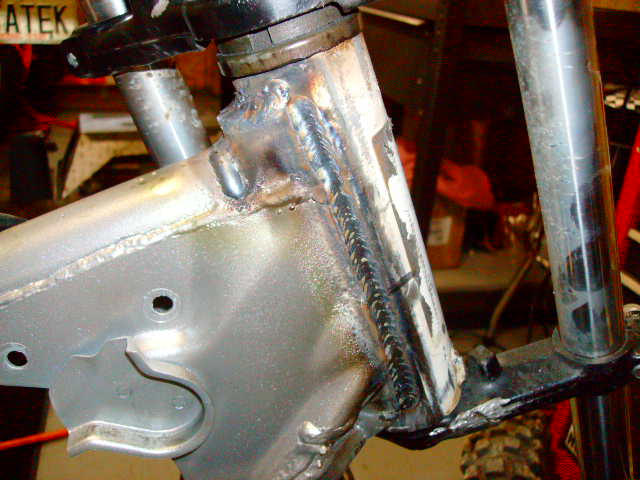

axulsuv Posted September 4, 2008 Author Report Share Posted September 4, 2008 (edited) A bit of progress today , should align , cut & weld the swingarm tomorrow . Then just wait for the 428 countershaft to get here and give it a test ride ! Then tear it apart detail & paint frame , rebuild the forks , decide on fork spring rates ? Lace up some 17x1.60 and 19x1.40 aluminum rims mount some Vee rubber tires And make it pretty again ... Well at least I'm not bored ! And having a neighbor that is a excellent welder and understands what is going on is great thing ! Glenn Edited September 4, 2008 by axulsuv Quote Link to comment Share on other sites More sharing options...
copemech Posted September 4, 2008 Report Share Posted September 4, 2008 (edited) I was wondering if you welded that----NOT!!!!!! You are sick man, you need to rest! Did you find tyres? Edited September 4, 2008 by copemech Quote Link to comment Share on other sites More sharing options...
axulsuv Posted September 4, 2008 Author Report Share Posted September 4, 2008 Cope , I can weld good , but not as good and consistant as my neighbor does ! (machinist/fabricator w/ about 40 years at his craft ...) And Vee rubber makes a 17x3.50 &a 19x2.50 that will work just fine . And all I have to do is call their USA. office in Atlanta and they put them on the UPS truck ! The price is comfy on them too and should be a much better tire than the chen shings . The Wheels will come from a shop in New Jersey that sells SanRemo rims , The only ones I could locate with the dimensions I need and 36 spoke count to match the honda hubs ... I beleive they produce the rims used on the Beta 50 ??? And I saw my doc. tuesday morning , You should see the size of the pin and medical duct tape holding my shattered clavicle together ! He said to only wear my sling if it hurts , don't lift anything heavy , and to do light reps of my therapy exercises so my shoulder doesn't stiffen up again ... And to come back on the 23rd to see when he wants to remove the pin . Glenn Quote Link to comment Share on other sites More sharing options...
