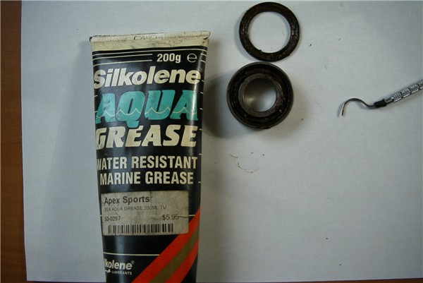

September 30, 200422 yr You can get a bit more life out of them if you pop the seal out with a small pick, I use a dental pick. Wipe the old grease out and put some good quality waterproof stuff in and replace the seal. Do this when you have the wheel off to change the tyre, don't wait until you have play in the wheel it only takes a couple on minutes. Do this with the bearing in the wheel, I took a photo of one I just took out of lads bike, he didn't bother to grease his and paid me to do it. Preventative maintenance is cheaper than paying Ishy to do it Edited September 30, 200422 yr by ishy
October 4, 200421 yr Just done 2 wheels tonight without any problems at all (for once...) A 14mm (9/16th) socket was small enough to fit inside the old bearing (disk side) and butted up nicely against the 'tube spacer'. I added an extension bar to the socket and tapped it with a hammer. The other bearing (sprocket side) popped out very easily followed by the spacer. I then spun the wheel round and used a larger socket inside the wheel hub and tapped out the other bearing. I don't think the 'tube spacer' would be damaged as only a little persuasion was needed. I followed Ishy's advice and prised the seals off both sides of each bearing before repacking with Marine grease. The hub was then cleaned up and smeared with 'Copper Grease' to prevent rust and help the new bearings slide in easier. They were tapped in using one of the old bearings, which meant that the hammer blows were spread evenly over the inner and outer shells. Thanks for all the advice everyone, I reckon I could replace both bearings on a wheel in under 5 minutes with no hassle at all in future.
