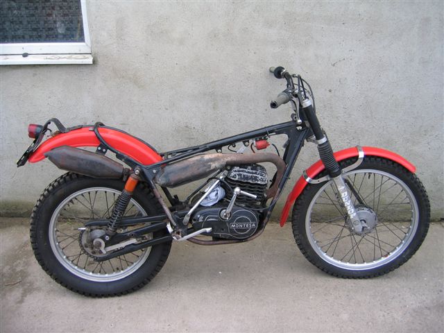

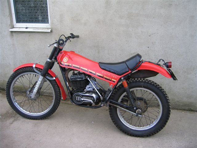

No both are 6 speed
An easy way to tell is that 348s have frame tubes under the motor 349s have an aluminium plate
348s have a rear frame loop and 349s don't
The motors look different too but it is hard to describe the differences
Both have motor prefix 51M
348 - 1976, 77, 78
349 - 1979, 80, 81, 82, .....
Edited by feetupfun
