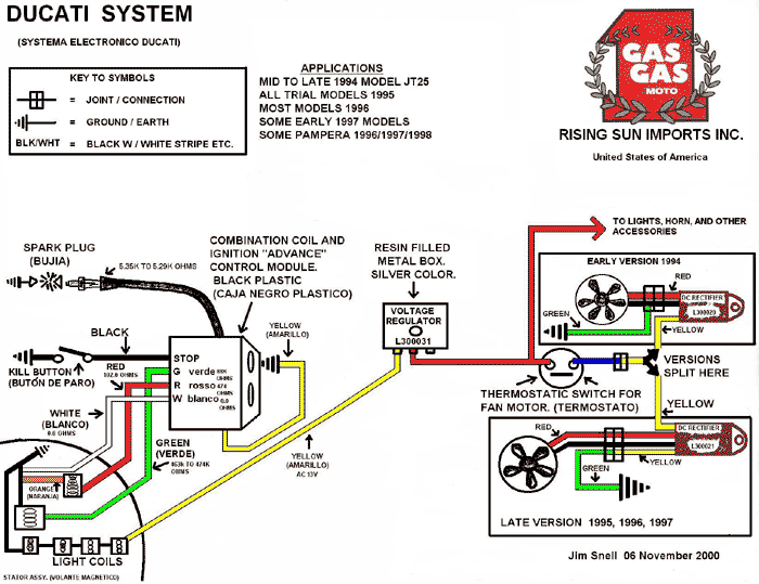

copemech Posted March 1, 2009 Report Share Posted March 1, 2009 A Ducati diagram. Quote Link to comment Share on other sites More sharing options...
