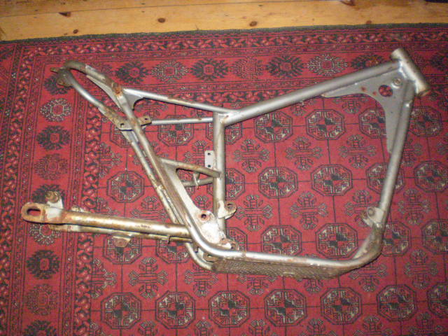

timbo Posted February 3, 2009 Report Share Posted February 3, 2009 I can add the white framed 198A's to the list, http://picasaweb.google.com/lh/photo/bChFl...feat=directlink I presume that they were produced by the factory to use up the old frames before the 198B came out,or maybe they were produced at the same time at a lower price? Quote Link to comment Share on other sites More sharing options...
