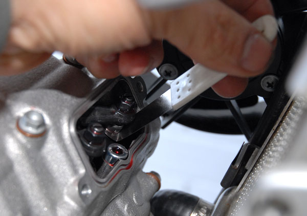

fivemeister Posted April 29, 2009 Author Report Share Posted April 29, 2009 (edited) Just checked the valves. Spoke to an owner at the weekend who managed it without disturbing the engine - but I can't imagine how on earth he did it? I rocked the engine forward in the frame (see picture) exposing valve covers and did the business with the clearances. A bit fiddly and I would recommend getting individual feeler gauges (mine are by WURTH) which you have to modify by bending the ends slightly (again see picture) Clearances from Lampkins are INLET 0.10 and EXHAUST 0.15 metric. Anyone not familiar with the procedure can view a tutorial on adv rider website - http://www.advrider.com/forums/showthread.php?t=55445 Edited April 29, 2009 by Fivemeister Quote Link to comment Share on other sites More sharing options...

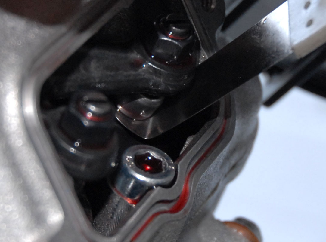

fivemeister Posted April 29, 2009 Author Report Share Posted April 29, 2009 (edited) Closer view of the valve check (don't make the mistake of trying to insert the feeler gauge on top of the rocker - which is above the blade in the picture) Edited April 30, 2009 by Fivemeister Quote Link to comment Share on other sites More sharing options...

jfc Posted April 30, 2009 Report Share Posted April 30, 2009 Just checked the valves. Spoke to an owner at the weekend who managed it without disturbing the engine - but I can't imagine how on earth he did it?I rocked the engine forward in the frame (see picture) exposing valve covers and did the business with the clearances. A bit fiddly and I would recommend getting individual feeler gauges (mine are by WURTH) which you have to modify by bending the ends slightly (again see picture) Clearances from Lampkins are INLET 0.10 and EXHAUST 0.15 metric. Anyone not familiar with the procedure can view a tutorial on adv rider website - http://www.advrider.com/forums/showthread.php?t=55445 What did you find, were the clearances out of spec? Quote Link to comment Share on other sites More sharing options...
fivemeister Posted April 30, 2009 Author Report Share Posted April 30, 2009 (edited) What did you find, were the clearances out of spec? No, they were absolutely bang on - no adjustment needed. Edited April 30, 2009 by Fivemeister Quote Link to comment Share on other sites More sharing options...
