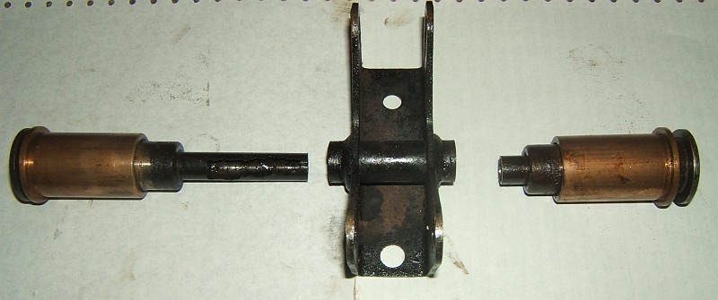

Not really, it can be a nightmare getting the spindle out if it's stuck though! I just did the job on my 340 Sherpa tonight in fact, typically absolutely seized in the rear engine mount.
I got it all out with no damage to frame or rear mount, but I do have the luxury of a fully equipped machine shop.
Mine are being replaced with a trick mod I've recently finished developing :D
I had to drill right through the centre of the spindle (From Each end) and only just broke through the O/D when as deep as the engine mount.
