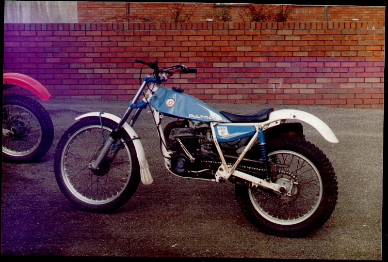

wayne_weedon Posted March 4, 2009 Report Share Posted March 4, 2009 (edited) Well didn't know if to start a blog or a forum topic but chose the latter. Some of you know I have a 199B Sherpa amongst my twinshockers and it's been with me a long time, BUT I had a long hiatus from the sport and a shorter one out of the twinshock business. Being slightly disinterested for a while meant I didn't even look at my bikes let alone look after them much, they had been in storage and thats about it. All "Fired Up" again now though and really feel guilty I left my bikes for so long, I also realised I'd lost out on a lot of fun. So my punishment begins! and the bike was completely torn down when I returned from a trial last Sunday. Took all of an hour to get it down to frame/swinging arm. and another 2 hours to get the Swinging arm out! I also be using the bike as a testbed for a few parts I have up my sleeve;) Here's a pic of the bike from when I first got her! Not bad original condition really. cont..... Edited March 4, 2009 by wayne_weedon Quote Link to comment Share on other sites More sharing options...

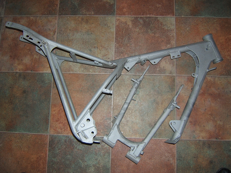

wayne_weedon Posted March 4, 2009 Author Report Share Posted March 4, 2009 Result of todays efforts by my Blasting people. Not a bad job especially for 25 quid, but they did miss a few tiny spots which still have white paint. I can deal with that though. Off to be powder coated next week after I have giving it a good going over on the weekend. A client has a powder coating line and some Signal White in stock so that should be a fairly cheap but good job too. To be continued... Wayne... Quote Link to comment Share on other sites More sharing options...

nigel dabster Posted March 5, 2009 Report Share Posted March 5, 2009 Whoa there fella. BEFORE you powder coat delug and move footrests back and get a bracket welded on for the exhaust at least. Quote Link to comment Share on other sites More sharing options...
nigel dabster Posted March 5, 2009 Report Share Posted March 5, 2009 key hole weld up and shorten the stops. Top tube looks straight. whats the frame no? 4*** and its one of the last of the last.......... Quote Link to comment Share on other sites More sharing options...
wayne_weedon Posted March 5, 2009 Author Report Share Posted March 5, 2009 key hole weld up and shorten the stops.Top tube looks straight. whats the frame no? 4*** and its one of the last of the last.......... *** = 282 Quote Link to comment Share on other sites More sharing options...
wayne_weedon Posted March 6, 2009 Author Report Share Posted March 6, 2009 (edited) BEFORE you powder coat delug and move footrests back and get a bracket welded on for the exhaust at least. As I said in PM I never had any real issue with stock Sherpa footrest position but I'm still open to suggestions as I've never bothered to try altering it. Never had too much trouble making the front end light being a 10-10.5 stone guy. The gusset the hangers are mounted on with the addition of an extra hole I guess could be made to accept a bolt on hanger plate which would allow me to play around with positions. What are other 199 owners opinions on footrest position?? If moved how far back and same height?? Still trying to work out what you mean by a bracket for the exhaust? Wayne... Edited March 6, 2009 by wayne_weedon Quote Link to comment Share on other sites More sharing options...
