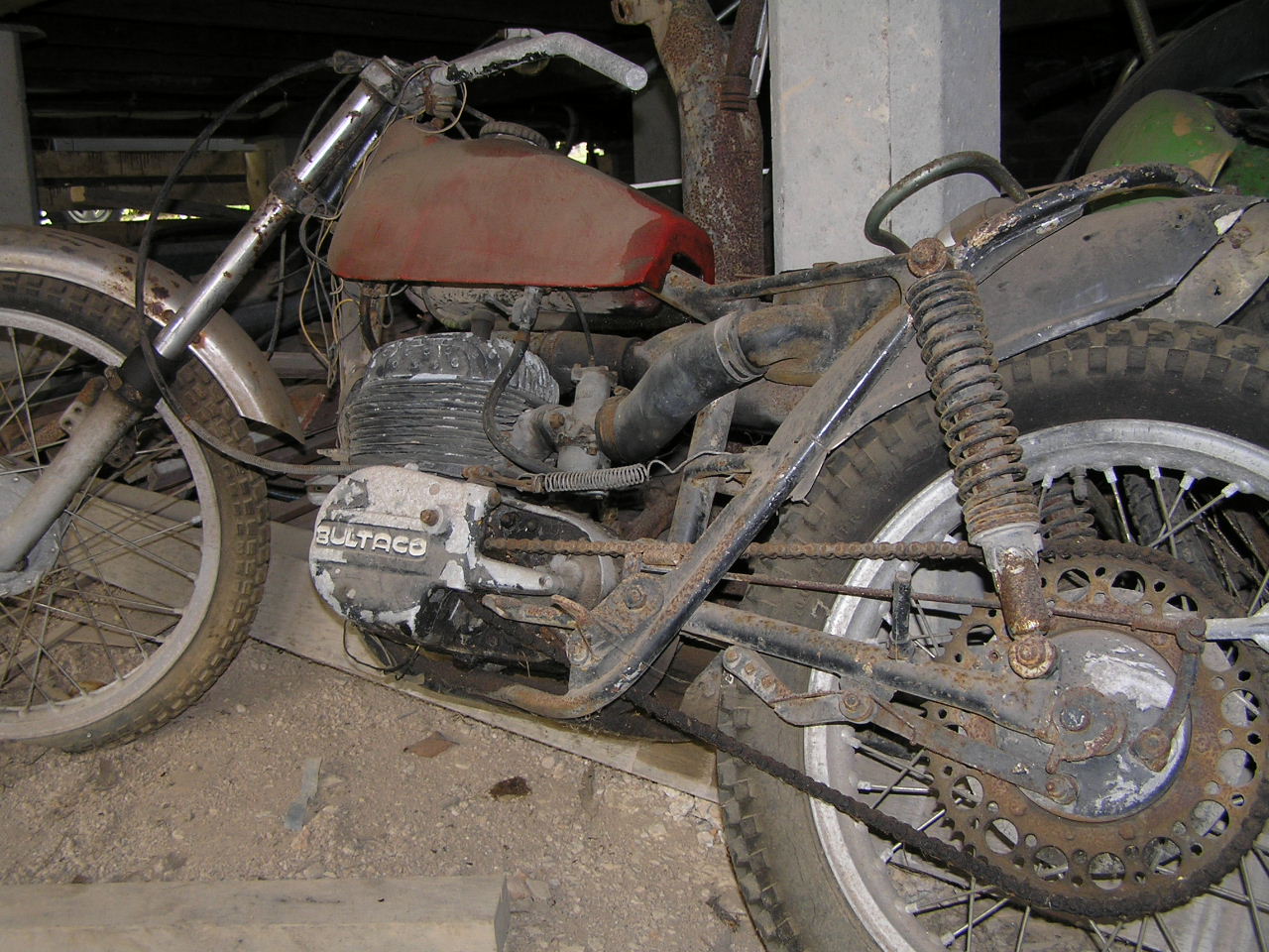

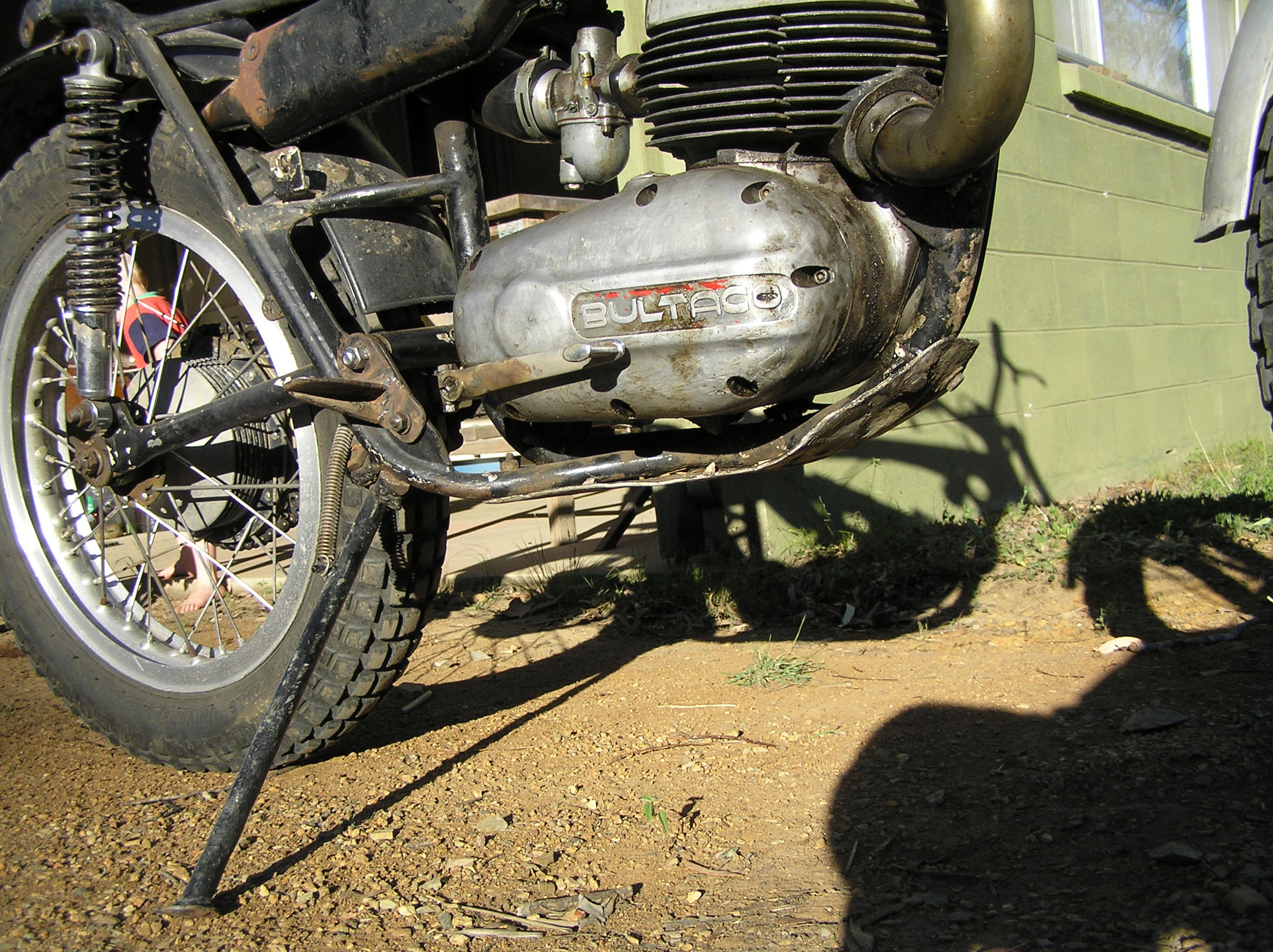

gomey68 Posted March 5, 2009 Report Share Posted March 5, 2009 Hi all, I have a M49 serial # M49005##, I believe it to be a so called series one. I need help with the correct rear brake lever and foot rest choice. As you can see in the pics the bracket for the rear brake lever seems to be behind the frame at foot rest level. I am thinking for this it is a long solid steel type? Any pics would help me locate one. The footrests I have seen can be the fixed platform type or the newer flip up type. Again any pics of the correct type to help me locate a set would be appreciated. Any information or chat about the M49 would be great! Thanks, :-) FRAME TOP RIGHT= FRAME TOP LEFT= REAR BRAKE FRAME BRACKET= LEFT SIDE VIEW= Quote Link to comment Share on other sites More sharing options...
