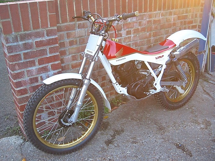

just like to share my new bike with you, its taken me a couple of months to get it like this from a standard tlr 200, I done 1 like this in 2002 but in blue\white colours,rode it for a while then sold it, theirs a pic of it somewhere on an earlier honda posting.
hope you all enjoy it :banana:

the tank and seat was bought from a guy called Henry who lives near Ashford in Kent, he told me it was his last one, I have since bought another one from a friend (as I have another Honda on the go ) who has them made so I maybe able to get more in a couple of weeks time the price is

Looking at the picture again the seat/tank unit looks very similar to my Gollner Monoshock TLR.
Does this use the normal TLR tank fittings rubbers at the front or is it held by a 'rubber band' ?
What capacity is the tank?
Where did you get the fuel cap - or alternatively what does the fuel cap come from, the cap on my bike which is still in 100 bits is a very poor fit.
I still fancy fitting this type of tank/seat unit to my twinshock TLR - either this or a Plastic tank from a Fantic or similar.
Gordon
Link to comment
the seat\tank unit is very similar to the gollner unit, as for fitting the ali tank NO it doesn't use any of the existing rubber fitting, just drill and tap it straight onto the top tube then space it up with rubber washers.
the fibreglass cover is held on at the front by the petrol cap, the cap is a screw type Yommee product bought from all good trials shops, it screws directly onto the ali tank
hope this is of help Booma
PS the bike is going up for sale, somebody is looking at it Sat 13/11, I will let you know the outcome
Link to comment
Thanks for the info
The tank fitment on my Gollner is not the best design I can think of (rubber bands to top tube) - whether this is original I dont know but I have some ideas in mind how to modify this when it comes to refitting the tank.
The tank top on my bike is a badly fitting simple plug in 'bung type' top, whether a replacement alloy tank has been made at one time I dont know, again this is something I am not happy with - hence the question about tank top.
The fibreglass cover is held at the rear by a bolt through the rear mudguard & rubber clip/band at front - this looks original but I probably have a couple of DZUS fastners looking for a home.
Looks kike a nice bike you have though
I see you have rebuilt the wheels - i take it due to 'Honda wheel rot disease' - did you bother with double diameter spokes
Gordon

your right the wheels had the dreaded rot so I had them rebuilt by a friend here in the southeast with Exel rims and large dia stainless steel spokes and nipples, lovely quality and very strong, not cheap but worth it.
As I put in my last post the bike was up for sale, well a friend of a friend has just been round and bought it :banana:
nice fat wallet again :P
so now I can start all over again with the next tlr 200 sitting in the back of my workshop
I think I'm going slightly mad :banana:
