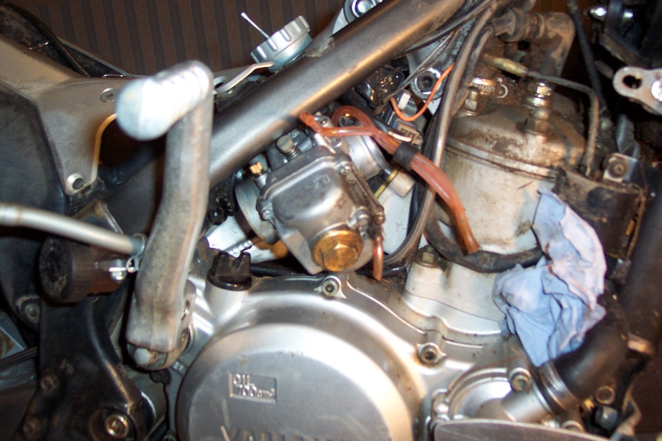

boofont Posted November 19, 2004 Report Share Posted November 19, 2004 I've had to get to the carb and I've done it two ways. First time I took it out without removing the airbox and subframe. It took a while and was a pain to put back. Second time I just took the subframe (with the airbox still attached) off. It took less than 5 mins the second time. About 6 hex head bolts I think and a screw driver for the airbox rubber. DF is right about the sprk plug, but to be fair it is not a big job to take the tank off. Two bolts, but is does take a "nack" to put it back on. Once you've done it a couple of times then you soon learn the score. I used to change the plug every time I took the tank off. On the advice of Marky Boy I now use a ...(shoots off down stairs to see which plug!)... NGK BKR6EVX. They're not cheap but I've had the same one in for about a year! Here's a picture I took when I first took the carb out. It shows just how tight it is. Go for the airbox every time. Its easy! Quote Link to comment Share on other sites More sharing options...

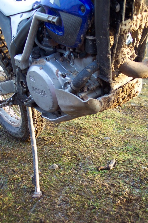

boofont Posted November 20, 2004 Report Share Posted November 20, 2004 Water pump protector? You can see the top of mine in the carb photo, here's another though. Quote Link to comment Share on other sites More sharing options...
