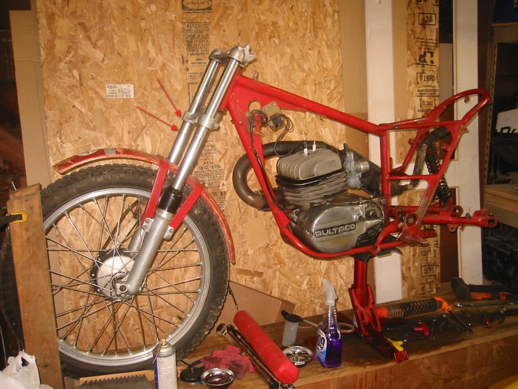

swooshdave Posted July 15, 2009 Report Share Posted July 15, 2009 Here is a picture of my forks. I've never figured out why the knurling is where it's at. I assume it's the wrong tubes. See the arrows. Quote Link to comment Share on other sites More sharing options...
greeves Posted July 16, 2009 Report Share Posted July 16, 2009 Swooshdave; that is simple. As you know in Bultaco they build their parts to fit in as much models as they could. That philosophy included of course the road, enduro, cross and trials bikes. It is very probable the knurling of those bars was done to fit Matador yokes or any other bike, but after fixed in a model 92. I have a model 91 with the same particularity. Quote Link to comment Share on other sites More sharing options...
gomey68 Posted July 21, 2009 Report Share Posted July 21, 2009 I have an early M92 with the knurled bits showing on the forks also. As you can see in the pic the knurls on my bike are above the yokes as compared to swooshdave's where his are showing below. Top yokes maybe different,,, Quote Link to comment Share on other sites More sharing options...
hoodie2 Posted July 22, 2009 Author Report Share Posted July 22, 2009 That one looks like it should have the non lowered steel bottom yoke. That would match up with the knurling. My fork tubes are tapered at the top and the knurling starts 200mm from the top. I just need to know which triple clamp I need for an M92 frame and these tubes. Will any lowered bottom yoke work with the right top yoke for the tapers, or are there a range of diferent bottom yokes? Quote Link to comment Share on other sites More sharing options...
swooshdave Posted July 23, 2009 Report Share Posted July 23, 2009 gomey68 said: I have an early M92 with the knurled bits showing on the forks also. As you can see in the pic the knurls on my bike are above the yokes as compared to swooshdave's where his are showing below. Top yokes maybe different,,, Those definitely look like tubes for a bike without the dropped lower yokes. What make mine so peculiar is the great distance between the upper yoke and the knurling. I can't imagine any Bultaco that would support those dimensions (I say this with very little research...) Gomey, do you bring any of those bikes to Chehalis to ride at The Farm? Quote Link to comment Share on other sites More sharing options...
paulmac Posted July 24, 2009 Report Share Posted July 24, 2009 I remember a story I heard that the knurling was there for the Road Race bikes - the story goes that the race bikes had shorter travel rear shocks set in a different position to the off road bikes and the front forks were just pushed up through the yolks to match - knowing Bulto's Quote Link to comment Share on other sites More sharing options...
