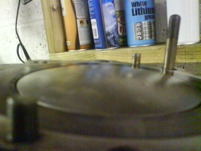

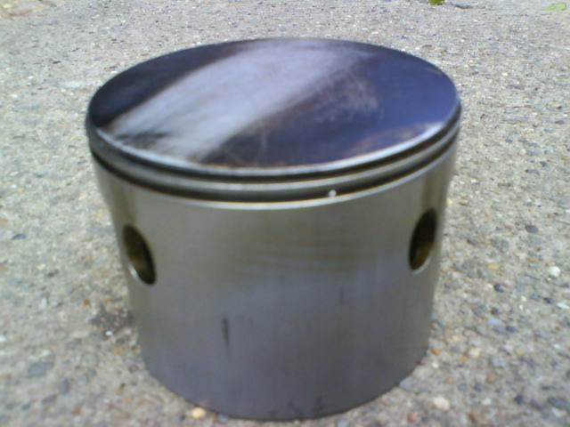

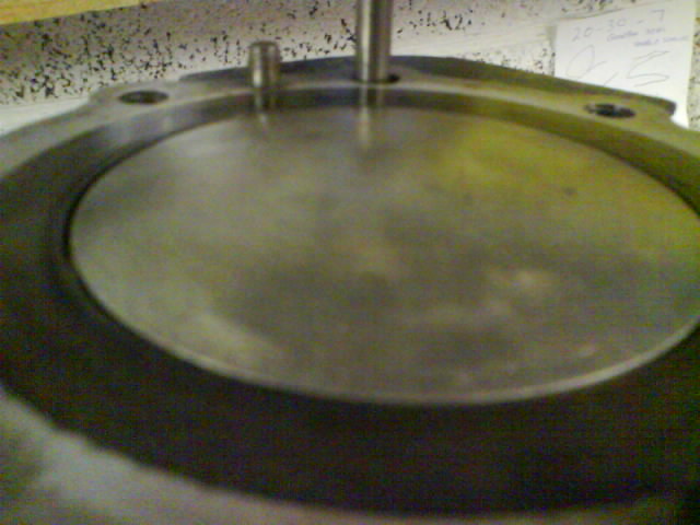

hewson Posted August 28, 2009 Report Share Posted August 28, 2009 Hi again , i've just took the head off a spare 199a 325cc engine i have , and this is as high as the piston goes with no base gaskets .The 199b 340 i have as a raised liner but its still the same with the piston top near flush with top of the liner ...Cheers Quote Link to comment Share on other sites More sharing options...
brt650 Posted August 28, 2009 Author Report Share Posted August 28, 2009 Wow this is the reason you join forums.Can't take for granted that I know everything. The photo's are great. The crankshaft may well have been changed.The barrell and cases have 159 numbers on them. Funny you mention different crank Hewson as the bike was fitted with a 71 sherpa tank and alpina seat. I fitted a new rod kit to the crank.I bought that from BultacoUK.It was the same as the one I removed.I'll check the stroke tomorrow . I'm not going to be happy if the crank has been changed. The chances of getting the right one will be hard for sure.Or maybe this engine was a special test engine? Quote Link to comment Share on other sites More sharing options...
